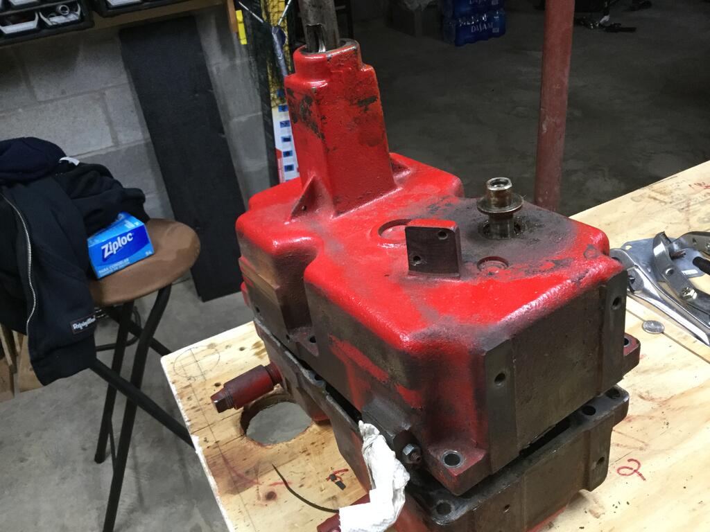

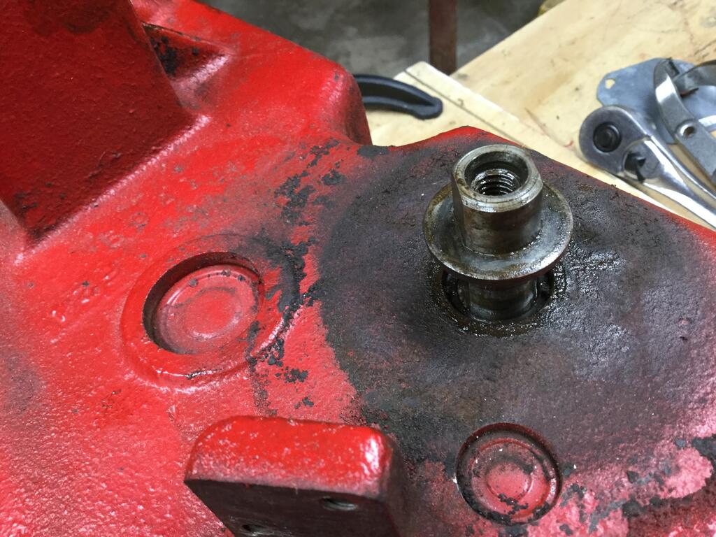

Klinger 17 #32 Posted December 17, 2021 Ok FINALLY!! Work has begun. But can someone please inform the dummy here (meaning me) why o why is this not coming off. Is the attachment for the brake drum suppose to be pulled off? Being quarantined is giving me the time to make accomplishments on the old girl , is I can first get the shell off first. Is the obvious hitting me in the face? Share this post Link to post Share on other sites
