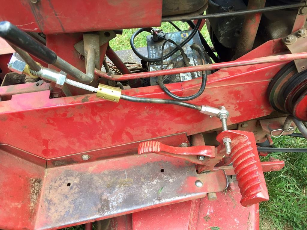

RJR49 179 #1 Posted July 15, 2017 Matt said it wouldn't work on a C Series but I bought one of his kits anyway. A couple of his parts, a few I made and I got it working. No modifications and a 20 minute install. It works great on my C-160, and I can't imagine it not working on a 1075 and everything in between. I don't use Matts reverse pedel very often as the lever is still there and raising your foot high enough to use his is awkward. Matt might want to pick up on this. If not I can put something together or provide drawings if anyone is interested 9 Share this post Link to post Share on other sites
Adams94 1,071 #2 Posted July 16, 2017 I have an original on my C195 and I love using it! 1 Share this post Link to post Share on other sites
