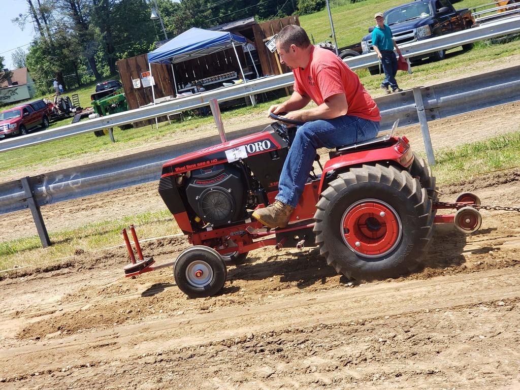

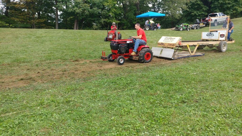

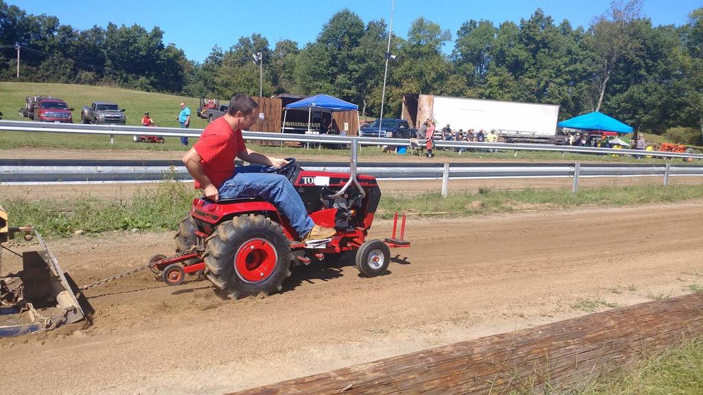

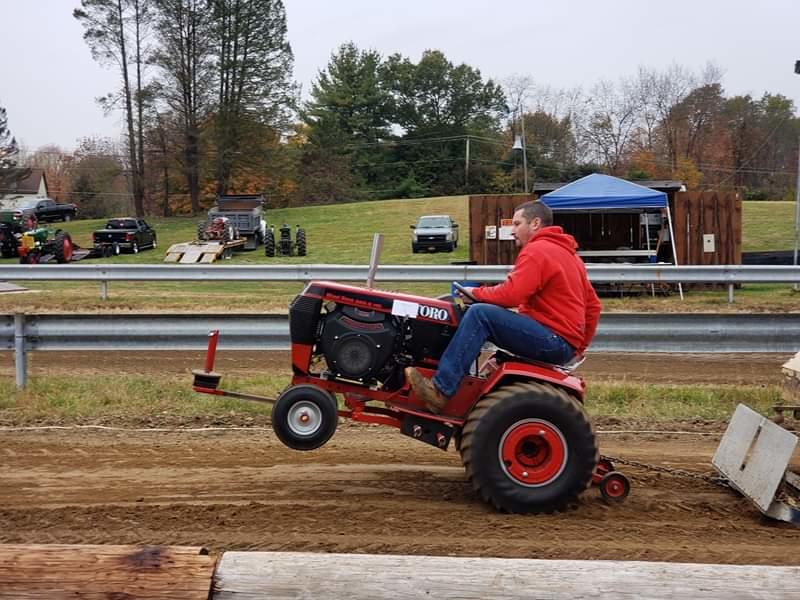

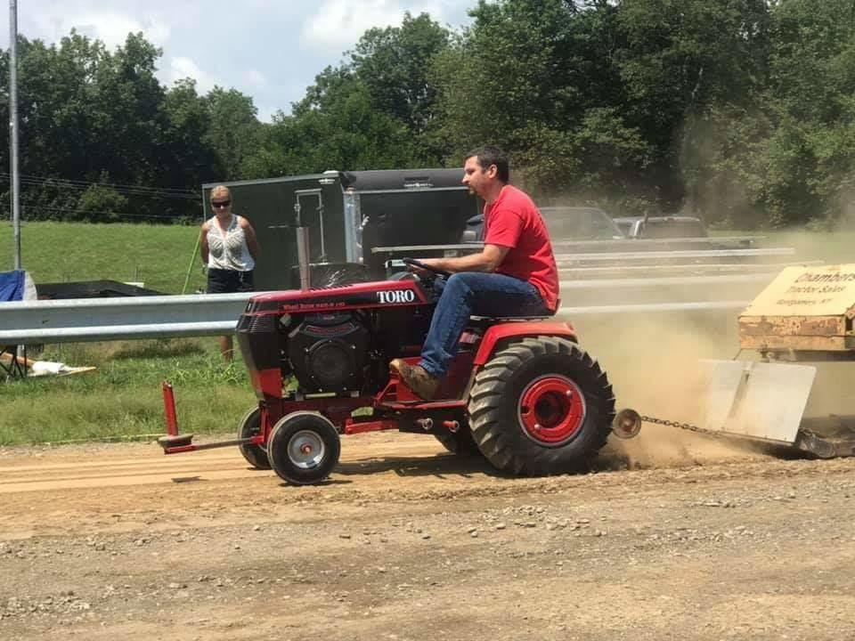

fast88pu 3,394 #228 Posted September 3, 2018 Some pulling photos 4 Share this post Link to post Share on other sites

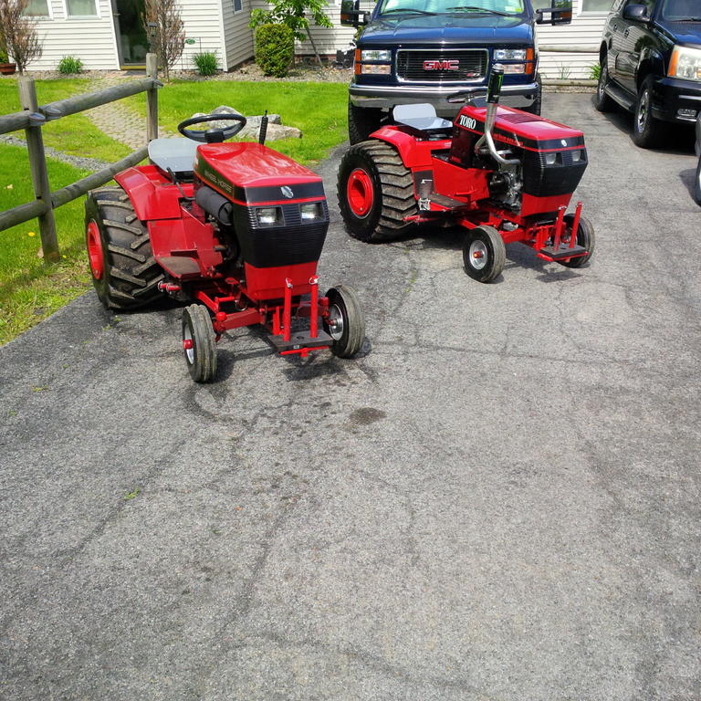

Pullstart 70,875 #230 Posted October 3, 2018 On 4/21/2018 at 7:26 PM, fast88pu said: All ready for next weekend. Second pic looks like dual stacks! 1 Share this post Link to post Share on other sites

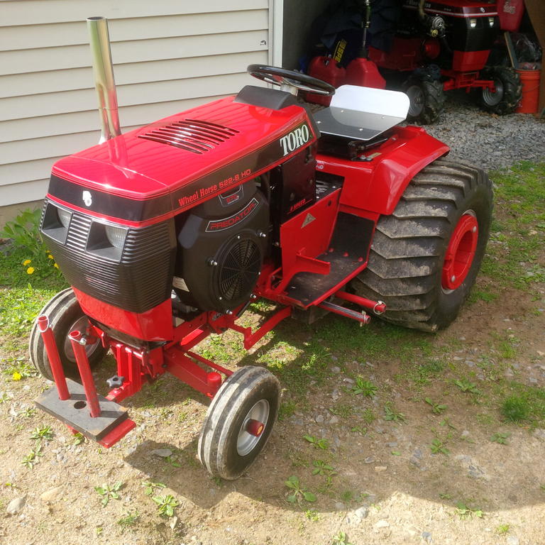

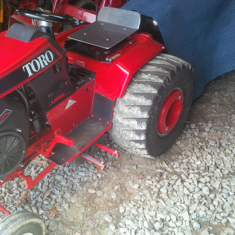

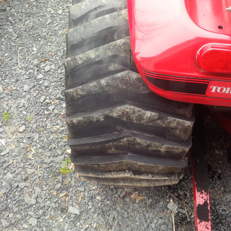

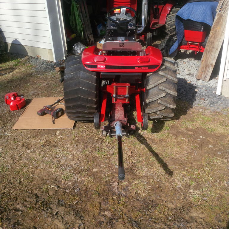

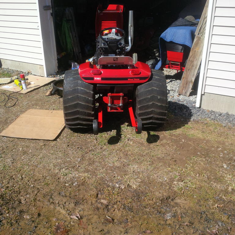

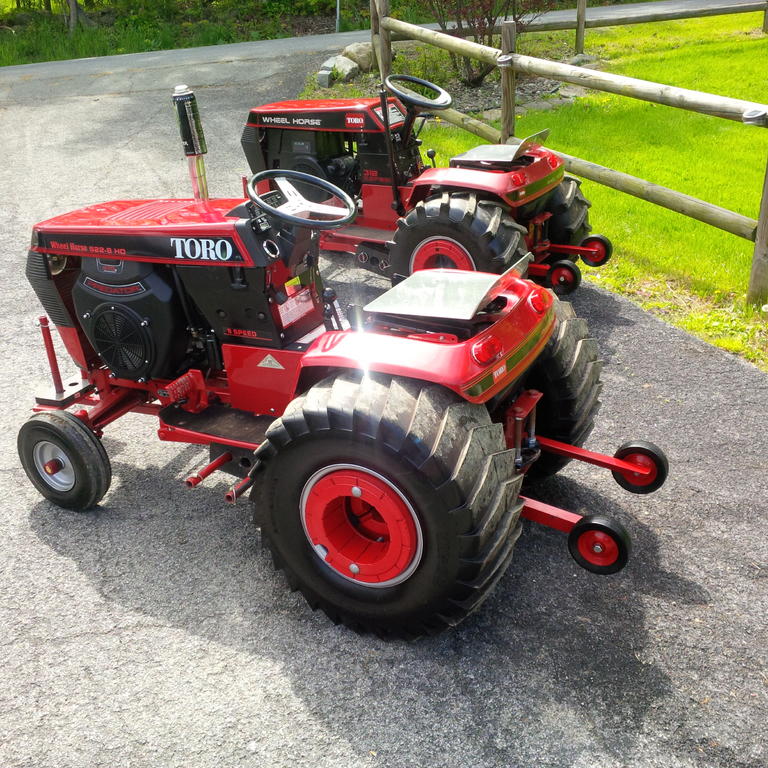

fast88pu 3,394 #234 Posted March 24, 2019 Well almost ready for this season. Fluids changed and filters. Put a little taller tire on it. It was also time to put pro pulling tires on it. I went with vogel vm09 tires. I had to make clearance for them by trimming the back lip off the running boards. Now I have 1/4" of clearance. Then new tires are about 2" wider too. Should hook and go now lol. 4 6 Share this post Link to post Share on other sites

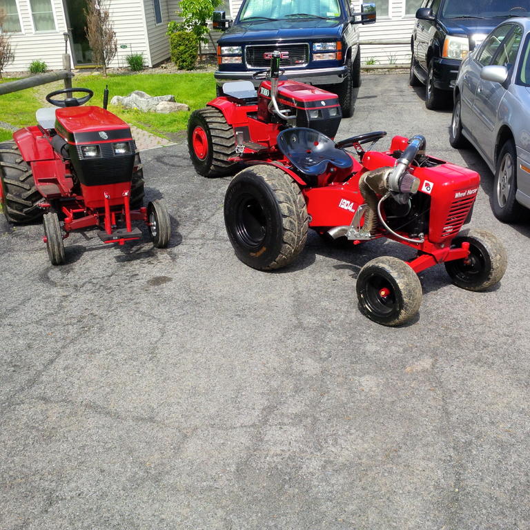

fast88pu 3,394 #235 Posted April 28, 2019 Clean and ready for next sunday 3 1 Share this post Link to post Share on other sites

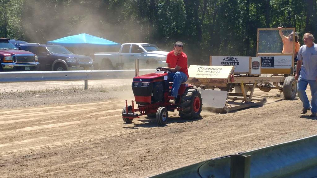

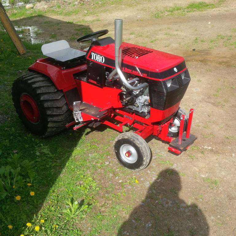

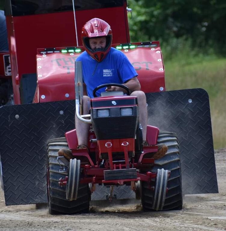

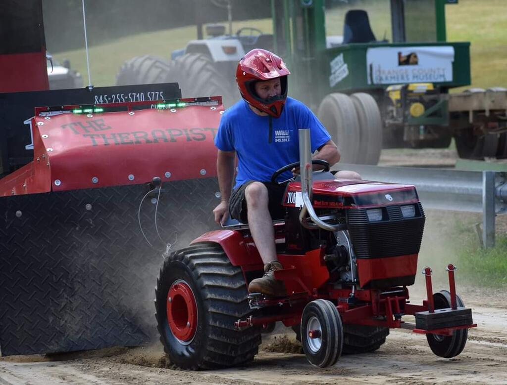

fast88pu 3,394 #245 Posted May 19, 2019 They both did well. I had to change the setup on the single and fix an issue on the twin. The twin spit some oil out of the breather right out onto the belt. So I had to change that. Aluminum tube now vents it to the ground. Guess their is a first for everything. 3 2 Share this post Link to post Share on other sites

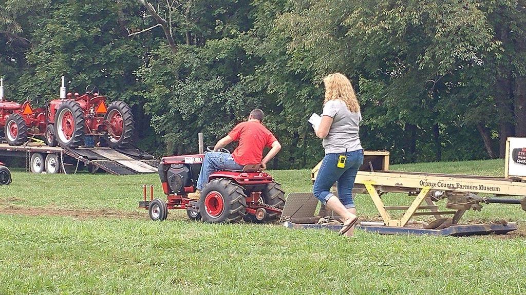

fast88pu 3,394 #246 Posted November 6, 2019 More photos of through the season as it is over now. 1 3 Share this post Link to post Share on other sites

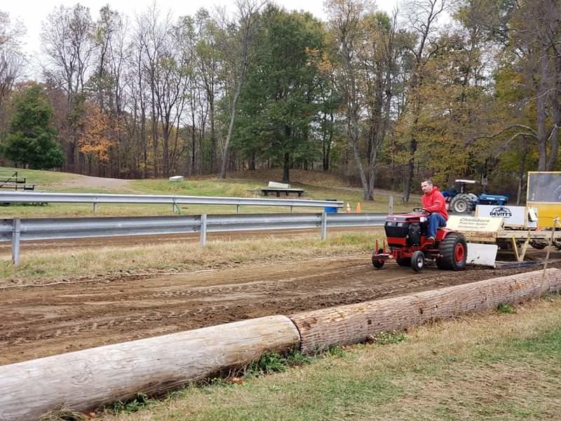

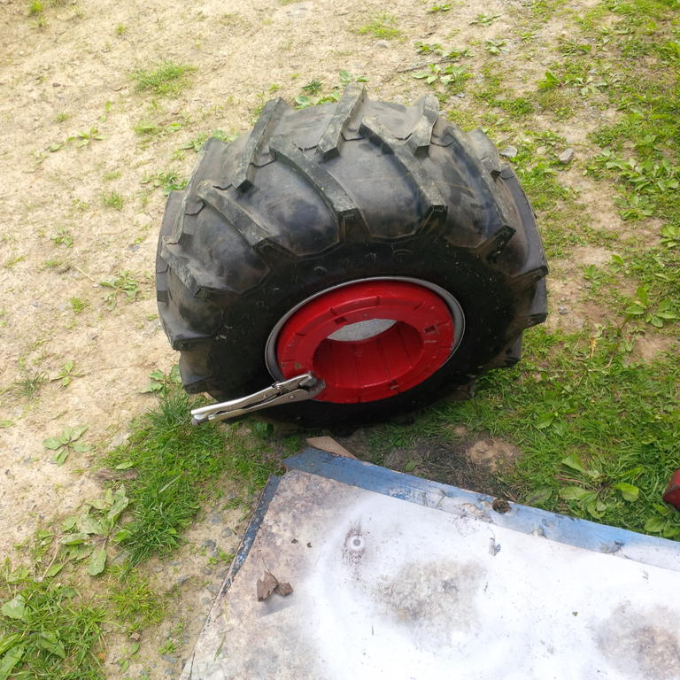

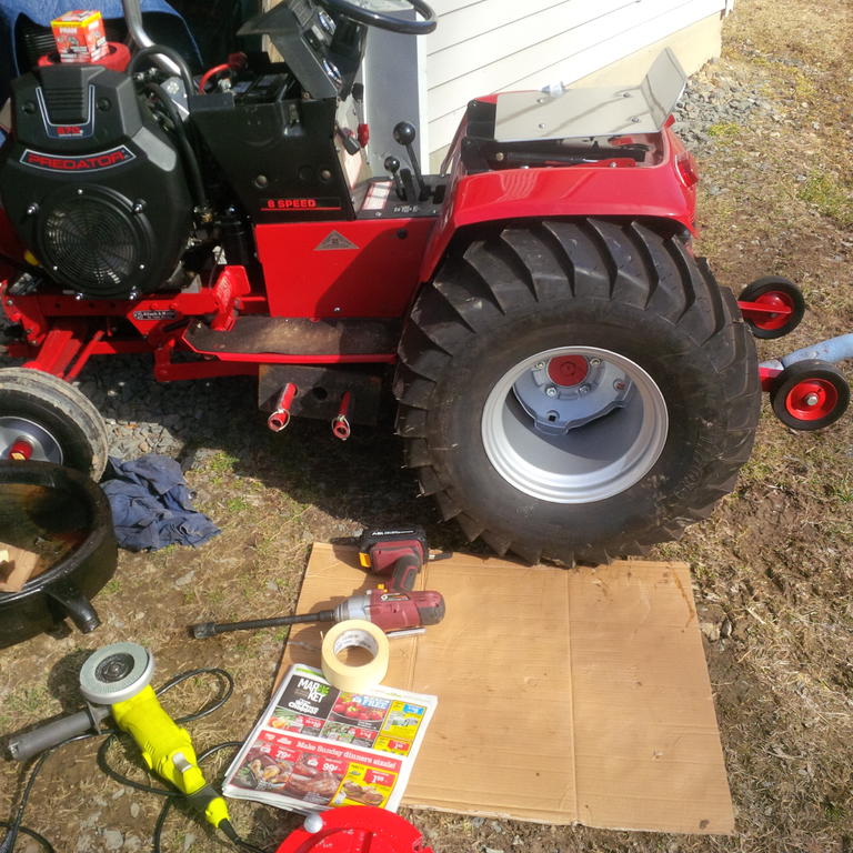

fast88pu 3,394 #249 Posted April 11, 2021 Last season photos. 1 Share this post Link to post Share on other sites

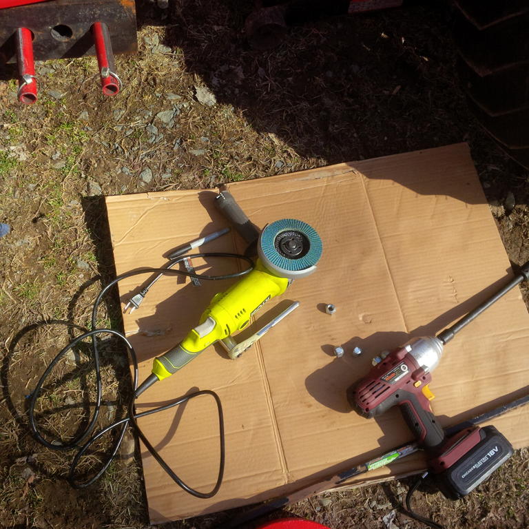

fast88pu 3,394 #250 Posted April 11, 2021 And now for this seasons prep, tire sharpening. 1 Share this post Link to post Share on other sites
