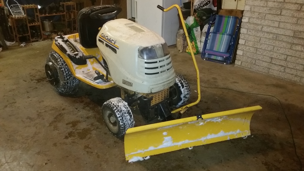

tallen4392 71 #1 Posted July 11, 2017 I have been looking on here trying to get some info on what is best front tire for pushing. Snow ag or what else u goys use thanks Share this post Link to post Share on other sites
andyk 83 #2 Posted July 11, 2017 I've had good luck with stock turf tread, 2 Share this post Link to post Share on other sites
SylvanLakeWH 29,886 #3 Posted July 11, 2017 Me too...standard turfs, no chain on front...works fine for Michigan's "snow"... Share this post Link to post Share on other sites
bds1984 1,506 #4 Posted July 11, 2017 I have a dedicated plow tractor, 1988 520H, that has loaded ags on in reverse and with a 25 pound weight bolted to the wheel. It actually steers pretty good except when I'm trying to push a big pile of wet snow while turning or when it is super icy out! Share this post Link to post Share on other sites
wallfish 18,791 #5 Posted July 11, 2017 Wrap the center of the front tires with #40 roller chain. Put them on tight with the tire deflated, then air them up and steer like it's on rails. Buy a 10ft length and an extra master link for about $20 or so. Don't use bicycle chain because it tends to roll on the tire. 2 Share this post Link to post Share on other sites
