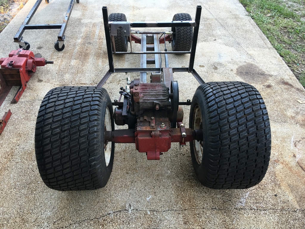

19richie66 17,930 #7 Posted July 11, 2017 24x12x12 Carlisle turf masters on 12" x10" wheels. I wouldn't think you would want to blow them out another 2". These sit just perfect on the rims. Not sure what tires you have, just an example 3 Share this post Link to post Share on other sites
