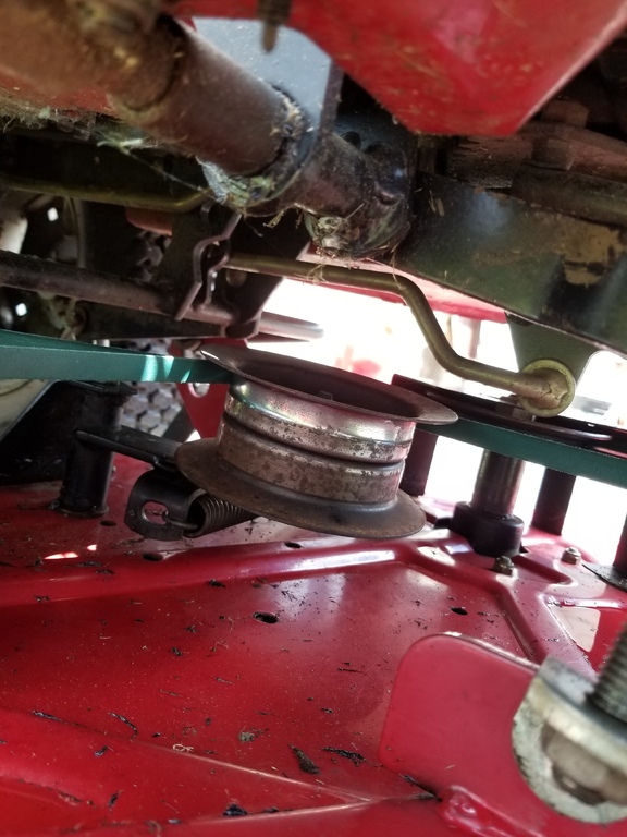

jonw440 196 #1 Posted July 4, 2017 I wrecked my new belt yesterday(must have had it threaded wrong) Picked up a new one today and tried the mower and it seems fine but...... I noticed the idler pulley has a serious groove worn in it where the belt runs. Can these be flipped over so the worn groove is at the bottom and the belt would ride on a new area of the pulley? Or should I just leave it as is. New pulley is around $65.00 Share this post Link to post Share on other sites

rmaynard 16,888 #5 Posted July 4, 2017 (edited) There should not be that much wear from the back side of the belt unless the pulley is dragging and the belt's too loose. Having said that, it does look like the pulley might be able to be flipped. However, it also doesn't look like a $65.00 idler to me either. Check places like TSC or McMaster-Carr, eBay or Amazon for a less expensive replacement. All you need is the OD, height, and diameter of the shaft. A pulley like that shouldn't cost more than about $10.00. Edited July 4, 2017 by rmaynard 3 Share this post Link to post Share on other sites
jonw440 196 #6 Posted July 4, 2017 36 minutes ago, rmaynard said: There should not be that much wear from the back side of the belt unless the pulley is dragging and the belt's too loose. Having said that, it does look like the pulley might be able to be flipped. However, it also doesn't look like a $65.00 idler to me either. Check places like TSC or McMaster-Carr, eBay or Amazon for a less expensive replacement. All you need is the OD, height, and diameter of the shaft. A pulley like that shouldn't cost more than about $10.00. Yea I routed the belt around something lastnight and destroyed the belt and thats when the pully got scored. The 65 was from toro parts. I could check TSC. 1 Share this post Link to post Share on other sites
daveoman1966 3,882 #7 Posted July 4, 2017 (edited) This place has the idler pulley # 92-7082 for about $45... AMAZON may also have that pulley...try them too. http://www.psep1.biz/arinet.asp?aribrand=TO#/Toro_Consumer/78216%2c_38"_Side_Discharge_Mower%2c_260_Series_Yard_Tractors%2c_1994_(SN_4900001-4999999)/CUTTING_UNIT_ASSEMBLY/78216-5492-1994/3316-730-6|~730002-0002 AMAZON IS $75.... just looked The link above is your best bet...about $45 Edited July 4, 2017 by daveoman1966 2 Share this post Link to post Share on other sites

skrusins 128 #10 Posted July 4, 2017 I would turn it over or place some washers under the pulley so the belt can ride more it the middle. Share this post Link to post Share on other sites
jonw440 196 #11 Posted July 5, 2017 I removed the pulley and was going to turn it over but there is a long sholder on the bottom side. I then thought I could push the bearings and "shoulder" out and re install on the other side, but there are two rubber seals protecting the bearings. I just re installed the way it was tried it and so far so good. I mowed for about 10 minutes and all is good. Share this post Link to post Share on other sites
