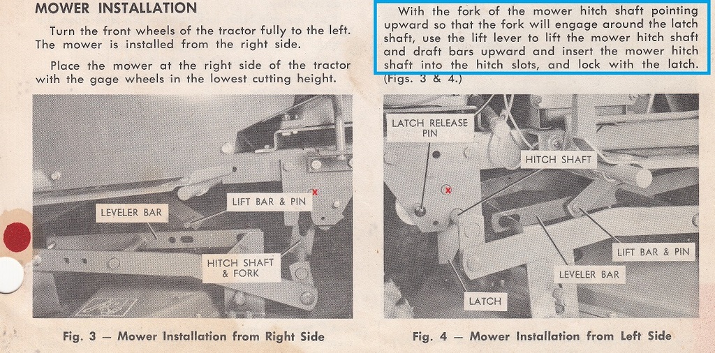

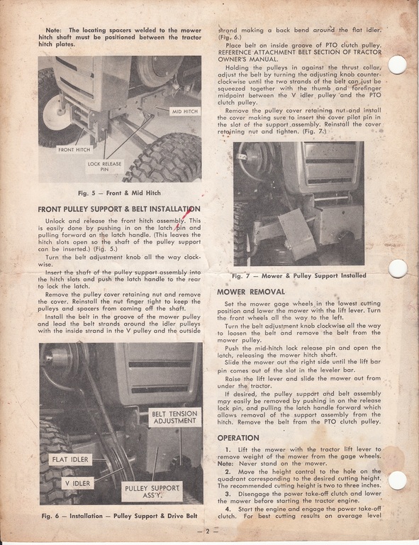

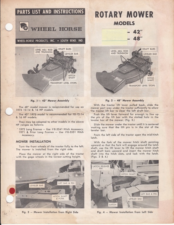

daveoman1966 3,881 #2 Posted July 4, 2017 These shulw help. Look at the section 'mower removal'. Share this post Link to post Share on other sites
RayW 0 #3 Posted July 4, 2017 Thank you Dave. These images are much better than what I have and I'll be sure to print them out. No luck though, I get to the 3rd step where it says to slide the mower out the right side and it won't move. Share this post Link to post Share on other sites
lynnmor 8,264 #4 Posted July 4, 2017 Did the bar drop down out of the hitch? Did you slide it off the lift bar pin? Are you raising or holding up the lift bar? There ain't nothing else. Share this post Link to post Share on other sites
daveoman1966 3,881 #5 Posted July 4, 2017 17 minutes ago, RayW said: Thank you Dave. These images are much better than what I have and I'll be sure to print them out. No luck though, I get to the 3rd step where it says to slide the mower out the right side and it won't move. Use the lift handle and raise the LIFT BAR (image 3) up out of the way. Then slide the deck out the right side. 2 Share this post Link to post Share on other sites
