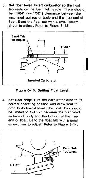

953 nut 64,160 #5 Posted July 4, 2017 A fuel pump or improper carburetor float setting could do this. Also a bit of junk in the fuel tank could be getting to the tank outlet, take a look. I would start with a new fuel line with a filter, ethanol-free gas, and some Seafoam fuel additive. Share this post Link to post Share on other sites

pfrederi 19,930 #9 Posted July 4, 2017 First check fuel pump remove fuel line into carb and crank engine should spurt out. Did you check the carb float setting? 2 Share this post Link to post Share on other sites
Brian pelphrey 4 #10 Posted July 5, 2017 Thanks for all the help!!! adjusted the Carb float setting and so far it seems to be doing great!!!!!! really appreciate all the help!!!!! 3 Share this post Link to post Share on other sites
