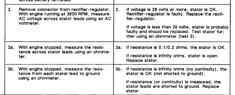

onisius 5 #1 Posted July 2, 2017 While mowing engine begins to slow and stall. Increase gas then puff of smoke comes up from under rectifier. Dead. Find three prong plug to rectifier melted in two places. One white stator wire and orange wire below it burnt and melted connector. Stator wires do not check as shorted to ground. Continuity check across reads 0.2 ohms. This is with cheap digital meter so don't know how reliable. No prior problems with battery charging or anything else. Really baffled at this. Have kept this machine going for 33 years now and have to decide if it's time to shoot the Horse and buy a Deere. If anyone has any ideas I would greatly appreciate any help. If anyone knows where to get rectifier part #101450 or stator for C-100 please let me know. These parts I'm sure are pricy if available at all. Need to decide if it is worth keeping up the fight. Thank you fellow members for any information you can forward. Onisius 1 Share this post Link to post Share on other sites
953 nut 63,991 #2 Posted July 2, 2017 3 minutes ago, onisius said: have to decide if it's time to shoot the Horse and buy a Deere. Don't do it! Sounds like the orange wire found it's way to ground someplace and drew an excessive amount of current. The readings you got on the stater sound good, probably fried the regulator. you can pick up a new 15 amp aftermarket rectifier/regulator on Ebay for less than $ 30. 1 Share this post Link to post Share on other sites
pfrederi 19,810 #3 Posted July 2, 2017 Welcome. couple more checks for your stator. when you get new regulator make sure it is well grounded, 4 Share this post Link to post Share on other sites
