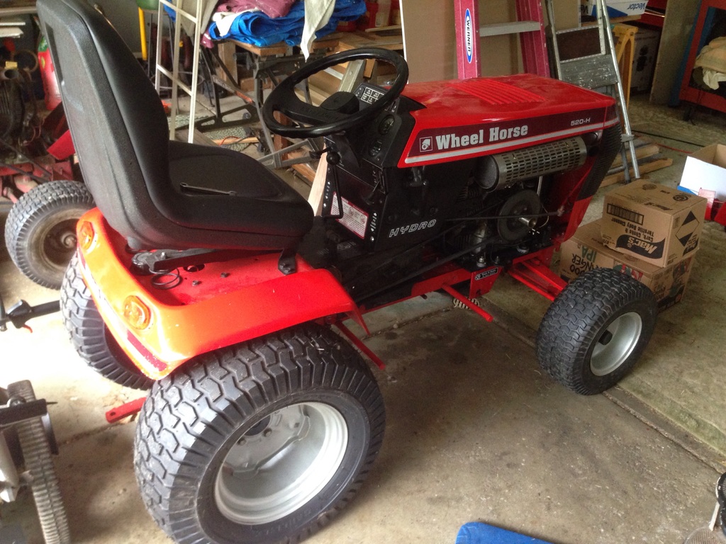

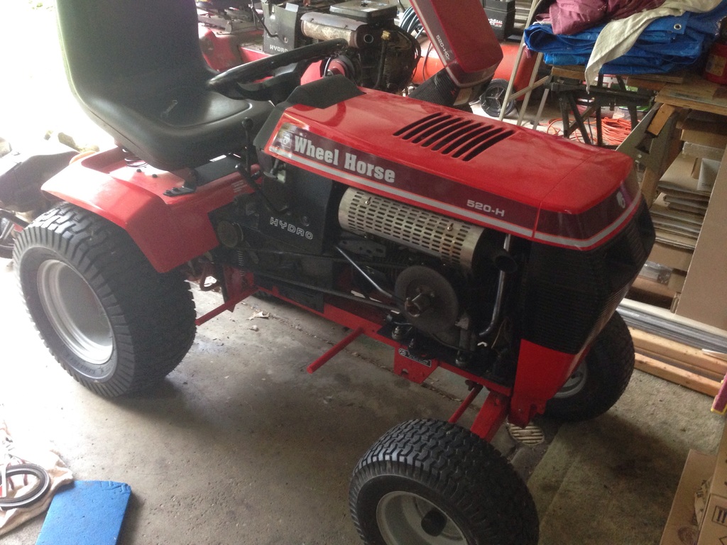

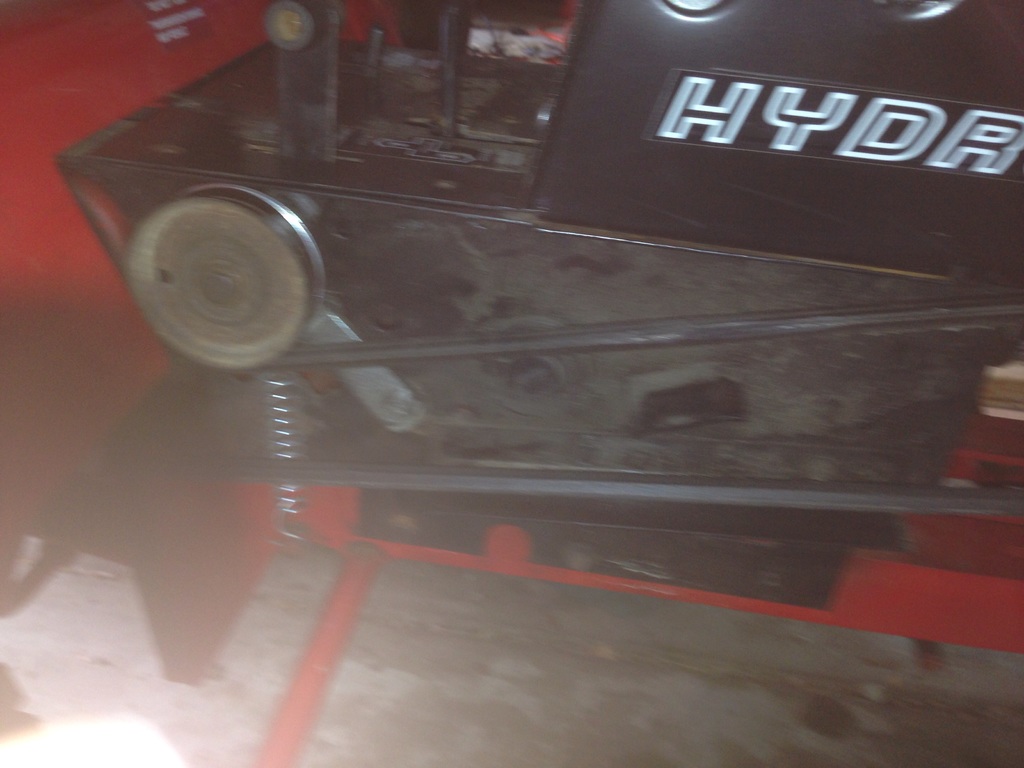

SadieCoonhound 8 #22 Posted July 1, 2017 Funky. Wouldn't doubt it. Runs pretty darn good. I hope the pictures went through. I'm going to button everything up. Sincere thanks to the horsemen 1 Share this post Link to post Share on other sites
ericj 1,579 #23 Posted July 1, 2017 if you pull the lever up to disengage the drive belt, does the tractor still move, will the lift still go up and down. if this all still happens with trans disengaged then the only possible solution would be wrong belt ????. everything looks correct in the pictures. the tractor looks very good also. eric j Share this post Link to post Share on other sites
SadieCoonhound 8 #24 Posted July 2, 2017 Funky town. I decicided before I buttoned everything up to go a head and put a new belt on. The old belt had some cracks and a little gouge in it. So I put the new belt on and believe it or not the engage/disengage miraculously operated exactly as it should have so all is well. Weird or as Eric says, funky. Strange, weird or funky all is well. So far. Thanks guys. And thanks Eric. It's a pretty little horse. 1 Share this post Link to post Share on other sites
