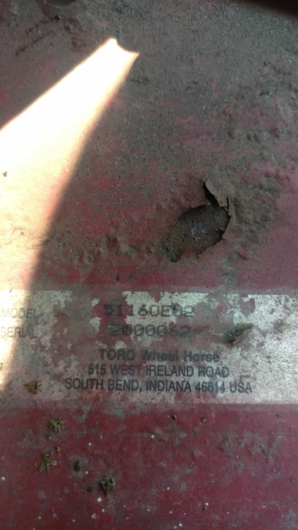

Fbillma 0 #7 Posted July 4, 2017 Sorry been a while, finally had a chance to mess with it again. Here's the sticker. After looking at the ignition switch again found the one terminal is loose at the switch. It says 111216 on it. Would a local tractor supply have those? I have known good battery in it. 9 pin connector looks solid. Share this post Link to post Share on other sites
gwest_ca-(File Mod) 11,853 #8 Posted July 4, 2017 Garry 1 Share this post Link to post Share on other sites
lynnmor 8,268 #9 Posted July 4, 2017 I've bought switches at NAPA. Other auto supply stores might have them as well. Share this post Link to post Share on other sites
