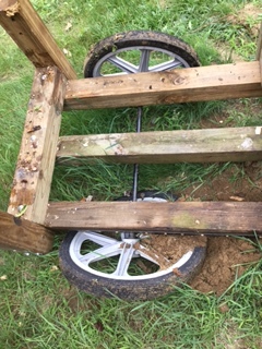

ebinmaine 75,779 #1 Posted June 27, 2017 Folks, What are the ways you're putting rear wheels on the front of tractors? I'm building a small log trailer on which is a 3/4" diameter straight axle and would reeely like to use the rear wheels and tires off my B80... Not looking for anything heavy duty and trying to be as "frugal" as possible. 1 Share this post Link to post Share on other sites

wallfish 18,789 #14 Posted July 3, 2017 Buy 1 inch OD DOM steel tube and cut to length. Slip it on to the 3/4 spindle and use the 1" ID bearings of the trailer hubs. I also drilled and tapped a hole in the end of the spindle for a bolt to hold it on with a washer and 1" ID shims. http://www.onlinemetals.com/merchant.cfm?pid=7776&step=4&showunits=inches&id=283&top_cat=197 1 Share this post Link to post Share on other sites
ebinmaine 75,779 #15 Posted July 3, 2017 9 hours ago, wallfish said: Buy 1 inch OD DOM steel tube and cut to length. Slip it on to the 3/4 spindle and use the 1" ID bearings of the trailer hubs. I also drilled and tapped a hole in the end of the spindle for a bolt to hold it on with a washer and 1" ID shims. http://www.onlinemetals.com/merchant.cfm?pid=7776&step=4&showunits=inches&id=283&top_cat=197 All Great ideas.. Thanks everyone ! I'm going to call the welder when he re-opens from the holiday and see how much he'll charge to make up a couple 3/4 id tube/ plate flanges for me. I have a decent drill press to put the 5-lug pattern in and a grease fitting. It'll cost just under $100 to buy the DOM/hubs/spacers to convert to trailer hubs so I can use that as a comparison figure. Like i said above I'm trying to be as frugal as possible but I also want this thing to last and be as safe/rugged as possible for the longest time possible. My Honey and I tried out the trailer for a few loads over the last couple days and it's about how we envisioned it but I had only the "temp" wheels on it (from a garden cart) and snapped them. We had to offload a bit sooner but we got a good laugh a little more exercise anyhow... Share this post Link to post Share on other sites
Sarge 3,470 #16 Posted July 3, 2017 With those type of loads and the side thrust those wheels will be subjected to - I'd just go straight to making up a different axle or find a used snowmobile / utility trailer axle and modify it . It's easier to source heavy wall (3/8" or greater) round or square tubing and buy a pair of hubs/spindles and give you tapered roller bearings that will withstand those high loads easily . For what you're doing - I'd shoot for the 5 bolt 3500lb spindles and whatever you want for wheels . If you have a local welder - get the correct spindles and give him the specs you want for width - he will have access to the proper round/square tubing and know how to weld it properly . My "yard trailer" weighs in around 450lbs empty . It's made from a 90* folded piece of diamond plate , some sheet steel and a lot of bracing . The axle was build from a set of 6 on 5.5" Toyota front axle spindles from a mini-truck (basically, 1 ton truck rated spindles) and a section of 4" heavy wall well casing . Sits on Toyota truck springs and I've had well over 5,000lbs in it - to the point of breaking the hydro drive belt on the old 1277 pulling it up a hill due to the weight . The trailer is almost 20yrs old now and has served us well around this area , hauling anything from rock to brush to black dirt and never blinked once . It took a load of broken concrete to break the original 2000lb axle I had narrowed in it , both spindles just folded up and this new setup should handle 5 times that load limit . Lot of guys also use old mini van rear axles that used the common 5x4.5" bolt pattern , some of those are fairly stout , too . If you could find one of the Toyota mini trucks , just grab it's rear axle and use that - they are one of the toughest axles ever designed for the given size/weight . Old Ford Rangers , Chevy S-10's , ect.... Sarge Share this post Link to post Share on other sites
wallfish 18,789 #17 Posted July 3, 2017 10 hours ago, ebinmaine said: Like i said above I'm trying to be as frugal as possible but I also want this thing to last and be as safe/rugged as possible for the longest time possible I'm not so sure you can have both. Now that you posted a pic and we see what you're doing, I'd recommend going on Craigslist and find a cheap trailer, easily modified for your purpose. Loose the springs and bolt the axle right to the frame if they can't handle the load plus it will lower it. There are 4471 trailers for sale in Maine and/or post a wanted ad on there too. Quicker, easier, will last much longer and possibly cheaper or the same price as well. Saw one on there for a hundred bucks but Maine is a big area. 2 Share this post Link to post Share on other sites
ebinmaine 75,779 #18 Posted July 4, 2017 19 hours ago, Sarge said: It's easier to source heavy wall (3/8" or greater) round or square tubing and buy a pair of hubs/spindles and give you tapered roller bearings that will withstand those high loads easily . For what you're doing - I'd shoot for the 5 bolt 3500lb spindles and whatever you want for wheels . If you have a local welder - get the correct spindles and give him the specs you want for width - he will have access to the proper round/square tubing and know how to weld it properly I'm thinkin' you're right... "side" loads are something I hadn't put enough thought to when considering my axle size. I designed the trailer to be able to hold about 1000 to 1200 pounds of wood but wouldn't often put that much in. I enjoy the experimentation of seeing what works and what doesn't... that didn't. I'll poke around online for parts prices and then go see Mr. welder dude. 11 hours ago, wallfish said: I'm not so sure you can have both. hehe.. I like a challenge. 12 hours ago, wallfish said: find a cheap trailer, Naahhh... I like to Build stuff. This trailer was/is made from scrap-pile pieces of PT deck rail posts I re-purposed from the front of my house when we ripped off the deck to install hand built granite steps made from ooold foundation stones. Share this post Link to post Share on other sites
wallfish 18,789 #19 Posted July 4, 2017 (edited) 39 minutes ago, ebinmaine said: Naahhh... I like to Build stuff. hehe.. I like a challenge. Can't argue with that logic. I've built many things which would've easier to buy. You can find stuff here https://www.surpluscenter.com/Wheels/Spindles-Wheel-Hubs/ Edited July 4, 2017 by wallfish Share this post Link to post Share on other sites
