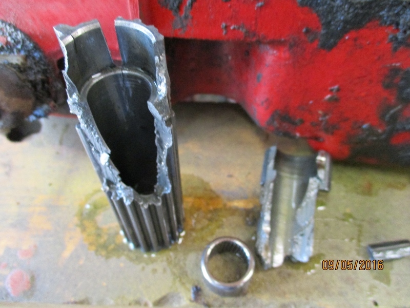

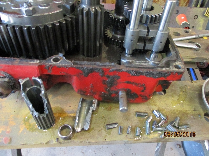

N3PUY 1,031 #26 Posted June 28, 2017 My neighbor broke the same gear last year. He was stuck in a hole and did something .... then came to me. 1 Share this post Link to post Share on other sites

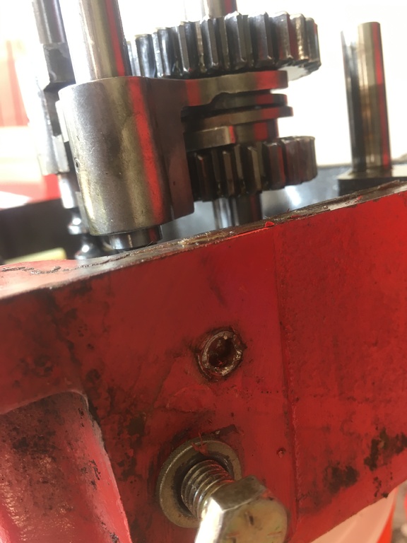

Kirbyhorse 4 #27 Posted June 28, 2017 The manual tells me to remove this plug with a screw driver, but I'm not sure how, any tips for removal? 1 Share this post Link to post Share on other sites
stevasaurus 23,536 #28 Posted June 28, 2017 It is just a plug...probably 1/8"...stick a screw driver or something in there and pop it out. You need this hole to be open 1/4" to put the detente balls and spring back together when the time comes. You may be able to pop it out from the inside...not sure...but just dig it out. When it is done, I like to put a dab of silicone calk in there...after we are done putting your trans back together. N3PUY...are you kidding me...that is exactly the same thing that is going on with Shawn. Very cool. I had to go back and look and see if it was the same trans and noticed it was a different trans...WOW. Share this post Link to post Share on other sites

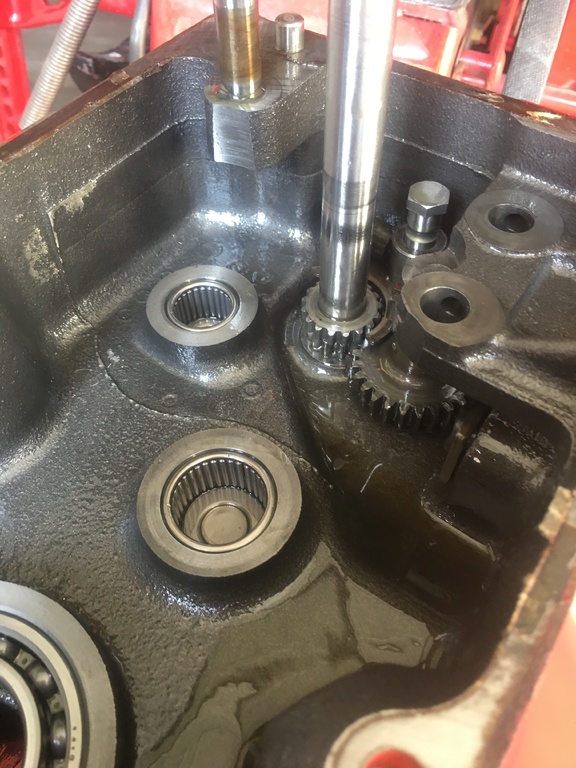

Kirbyhorse 4 #29 Posted June 28, 2017 Alright I got the plug out and the shifter forks and rails out and can pull the input shaft out Share this post Link to post Share on other sites
stevasaurus 23,536 #30 Posted June 29, 2017 Excellent, take a couple of pictures of the parts that you think are no good. We will find the part numbers and start looking for replacement parts Make sure no bits are down there where that hi/low mechanism is. Share this post Link to post Share on other sites
N3PUY 1,031 #31 Posted June 29, 2017 The gears that I needed for repair were over $600. A friend gave me his broken 1" axle transmission (axle broke off in the diff) and it had everything I needed for repair at "$0" cost. Problem is the trans is still on the bench 4 months later. Oh... I did buy a new gasket. 1 Share this post Link to post Share on other sites
