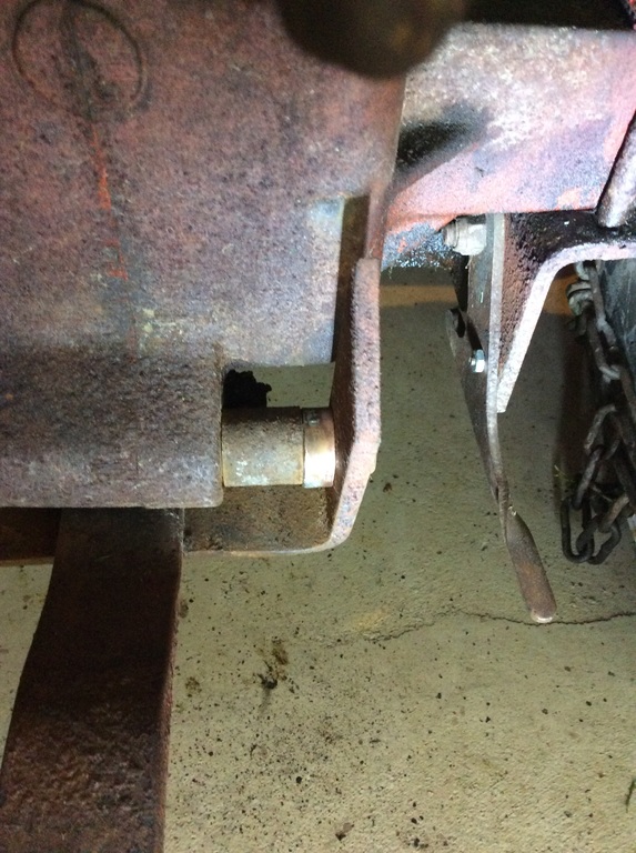

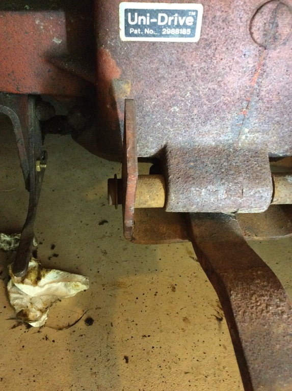

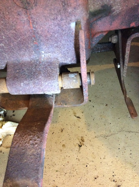

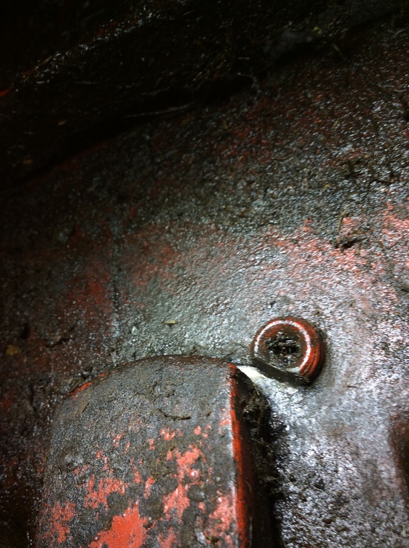

pen414 13 #1 Posted June 23, 2017 (edited) I have a bunch of firewood to move and want to use the 414-8 for that this summer. In preparation for the work I went to drain the transaxle and put new fluid in but found that the drawbar has been rubbing on it. I don't dare remove it until I have a replacement. I'm guessing it is a standard plug but was hoping someone has the size to be sure I get the right one. I'm surprised the drawbar moved enough to hit the plug. The limiting pieces of "tube" don't look worn, but I added a piece of copper pipe to restrict movement so it doesn't happen again. Hoping that in trying to remove this worn plug it cooperates as I'm pretty certain the oil in the transaxle is original and well due for a change. Advice is always appreciated. Thanks in advance, Edited June 23, 2017 by pen414 Share this post Link to post Share on other sites

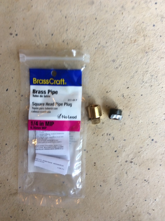

WHX?? 53,280 #2 Posted June 23, 2017 Should be 1/4" npt I believe. Some guys like to jack up the front of the tractor when draining to get the oil out that sits in front of the middle bottom bolt bosses. 1 Share this post Link to post Share on other sites

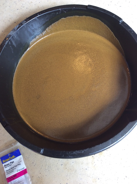

pen414 13 #7 Posted June 25, 2017 Old plug came out without much incident. Put PB blaster on it a few times over the last few days which couldn't have hurt. old oil was well past due being replaced. Used a brass replacement that sticks down more than the orig but has protection from the draw bar and the plow support bracket so I don't think it will be a problem. Thanks guys. Here are a few pics. 3 Share this post Link to post Share on other sites
Racinbob 12,421 #8 Posted June 25, 2017 Good idea. It won't stick down far enough to cause a problem. You probably should flush it before you put in fresh oil. That's pretty grungy. If you already put the new in no problem but I would change it again after some run time. 1 Share this post Link to post Share on other sites
pen414 13 #9 Posted June 26, 2017 51 minutes ago, Racinbob said: Good idea. It won't stick down far enough to cause a problem. You probably should flush it before you put in fresh oil. That's pretty grungy. If you already put the new in no problem but I would change it again after some run time. Thanks for the suggestion. I don't have any diesel around so I just put the new oil in and figure I'll drop that out towards the end of summer and see what it looks like. Diesel flush the common plan for cleaning it out? Share this post Link to post Share on other sites
Racinbob 12,421 #10 Posted June 26, 2017 Yes, that's probably the most common. I use Motor Medic motor flush and let it soak some. One quart is enough. 2 Share this post Link to post Share on other sites
