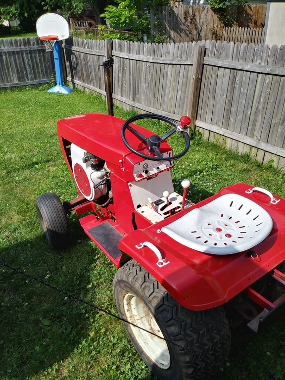

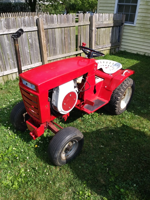

ChappyISP 3 #1 Posted June 21, 2017 Just bought.. What model year? Any info on it would be great. This was on tag. 01-11B804-23189 1085 Thanks Glenn 3 Share this post Link to post Share on other sites
slammer302 2,156 #2 Posted June 21, 2017 Gt2500 Front wheels and tires look original Share this post Link to post Share on other sites
ChappyISP 3 #3 Posted June 21, 2017 Thank you can you tell me year made and is it rare? I am going to do full restoration Share this post Link to post Share on other sites
slammer302 2,156 #4 Posted June 21, 2017 81 year. They are kinda rare but not really sought after. They came with a Briggs motor but urs looks changes to Kohler that's a plus but not original. 2 Share this post Link to post Share on other sites
rjg854 12,684 #5 Posted June 21, 2017 10 minutes ago, ChappyISP said: Thank you can you tell me year made and is it rare? I am going to do full restoration Really Looks pretty nice the way It Is 1 Share this post Link to post Share on other sites
ChappyISP 3 #6 Posted June 21, 2017 Thank you yes has kohler as it was uses for tractor pulls.. Need a carb and battery. Any help anyone can give would help i am new to this resto stuff so i am sure i will have many stupid questions Share this post Link to post Share on other sites
slammer302 2,156 #7 Posted June 21, 2017 Looks good carb rebuild kits are easy on the old Kohler engine Share this post Link to post Share on other sites
ChappyISP 3 #8 Posted June 21, 2017 My problem is it came with no carb... Share this post Link to post Share on other sites

TDF5G 2,073 #20 Posted June 22, 2017 Your horse looks mighty fine. Good luck with your project, it will be fun! 1 Share this post Link to post Share on other sites
