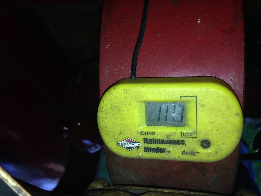

formariz 12,354 #6 Posted June 21, 2017 (edited) Expanding a little on my original reply, one of the reasons I wanted to use them was also as an hour meter specially on NOS engines which I put to service. That feature however was disappointing because like I mentioned, eventually the battery goes, and so does the memory even though I managed to change battery. As for using it to keep track of hours between oil changes it is not really that convenient for it, since it cannot be reset, so one would always have to keep a log of the hours on it. For that purpose i have another type similar to it, that all it does is specifically that, and it is able to be reset. Will post photo of it later. Also the newer models one can "program" it for different type of engines depending how engine fires. Found them to be sometimes hard to program and even after that not accurate. I have a couple of Kohlers for which I was actually never able to program it. The older versions were better in my opinion, since they were designed for a particular type engine, so they were fool proof. Edited June 21, 2017 by formariz 1 Share this post Link to post Share on other sites
