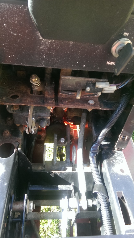

Paul Van Benschoten 18 #1 Posted June 20, 2017 I have a 520H that does not go back to neutral from reverse when pressing the brake pedal. I need to manually move the motion lever back to neutral. It works fine when going forward and pressing the brake pedal. I have the Eaton 11 manual and I did the neutral adjustment on page 13. I raised the rearend and moved the cam so that the wheels do not spin when the motion lever is in neutral. When driving the tractor in either direction, it stops when moving the motion control by hand. With the tunnel cover off it looks like the levers/cams that move the control back towards neutral do not immediately engage when the transmission is in reverse. This leaves the motion control arm still in reverse when the brake is applied. Is there some adjustment in there? I do not see anything in the Eaton or Owners manuals about the brake return to neutral linkage. Share this post Link to post Share on other sites

Paul Van Benschoten 18 #3 Posted June 20, 2017 (edited) 1 hour ago, WVHillbilly520H said: if it's a column shift check for binding,rust, and spring damage The column mounted motion control arm moves freely and does not bind in any direction. It is just the part with the (sort of) rounded triangle hole that moves the bearing doesn't push the bearing all the way back to neutral from reverse. I will remove the battery like you suggest, and put some penetrating oil on the pivot points. (and the tower cover plate too) Edited June 20, 2017 by Paul Van Benschoten 1 Share this post Link to post Share on other sites
