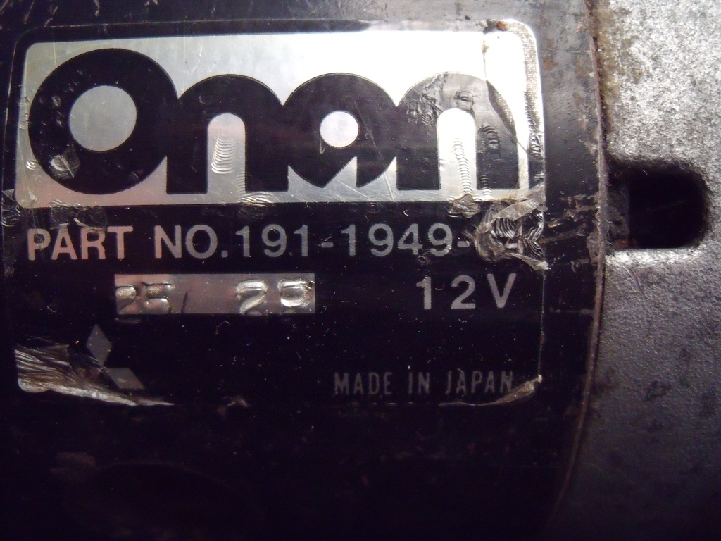

tbirdsteve 11 #1 Posted June 20, 2017 G'day All, I have a question about my 1993 520H with Onan P220g engine. It seems the starter motor has decided to retire. In order to purchase a new motor or repair parts from the web, I need a model number. The decal showing the model number is damaged right where the last 2 numbers are (murphys law). Can anyone tell me what model it might be?? The solenoid is fine but the motor itself turns for a few seconds, slows then stops (just in case anyone has an idea what the problem might be). I have opened it up, cleaned it out, brushes are good, armature checks out ok. Thanks in advance. Share this post Link to post Share on other sites

oldlineman 1,596 #4 Posted June 20, 2017 No sure but from your picture the last two numbers look like 04 worth a chance and try using them. 1 Share this post Link to post Share on other sites

boomers_influence 106 #6 Posted June 20, 2017 tbird the starter # is 191-1949-04. 191-1808-04 is the prior # thank you. boomer ( the used onan engine parts guy,also NOS and new) 1 Share this post Link to post Share on other sites
tbirdsteve 11 #7 Posted June 22, 2017 (edited) Thank you All, it is indeed an 04 model once it was pointed out. Appreciate all your replies and will follow all advice. Boomer I may contact you in future as the next step is removing the flywheel for inspection. There are many small pieces of magnetic metal stuck to the shroud so I would guess the magnets on the flywheel have self destructed. Just out of curiousity, are the magnets available separately? I see lots of videos on youtube about gluing magnets but google is unable to locate magnets as spares. Many thanks, Steve. PS I haven't seen this motor run yet, although I was assured it does, but i'm tending to think more a case of it did. I'm restoring this tractor to use. Edited June 22, 2017 by tbirdsteve Share this post Link to post Share on other sites
