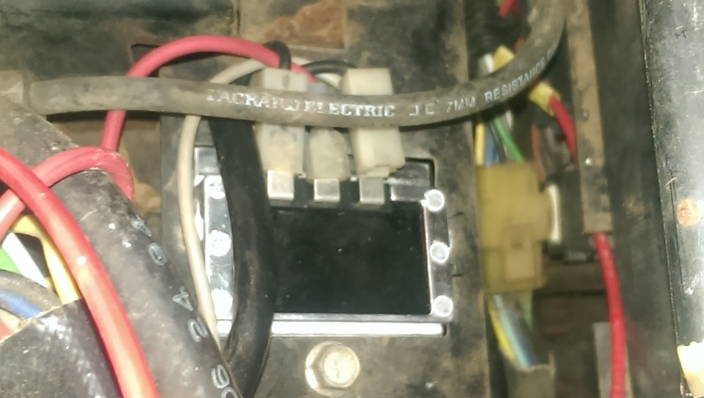

jmunzke 1 #7 Posted June 19, 2017 Thanks for the great info. So far switches seem to be mechanically operable. 9 pin looks ok. I found this (see pictures) which looks like a chip or relay? Has a burned white wire going into it. What is it? Share this post Link to post Share on other sites
lynnmor 8,588 #8 Posted June 19, 2017 It's the voltage regulator, you need to fix that. Probably not the issue you are after, but still needs done. 1 Share this post Link to post Share on other sites

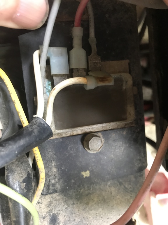

jmunzke 1 #9 Posted June 20, 2017 Eureka! Thanks to all the advice here for the novice visual learner. After checking all the switches, unplugging and re-plugging every electrical connection, and generally just trying to clean things up in there; I discovered the issue, or part of the issue. The PO put an inline fuse holder for glass fuses. The holder was not holding the connection tight enough to engage the fuse. I changed it out for a flat fuse style. Voila. And I didn't change the regulator, but put a new blade where it looked like it had been shorting, Will keep an eye on that. Napa says those regulators are 85 bucks! Does anyone have a more affordable solution should I need one? 1 Share this post Link to post Share on other sites

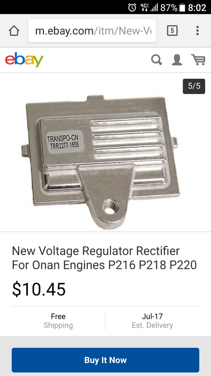

WVHillbilly520H 10,378 #10 Posted June 20, 2017 2 hours ago, jmunzke said: And I didn't change the regulator, but put a new blade where it looked like it had been shorting, Will keep an eye on that. Napa says those regulators are 85 bucks! Does anyone have a more affordable solution should I need one? Yes sir, eBay or Amazon $10-20 and yes I have an eBay version on one of mine and so far no complaints, Jeff. 1 Share this post Link to post Share on other sites

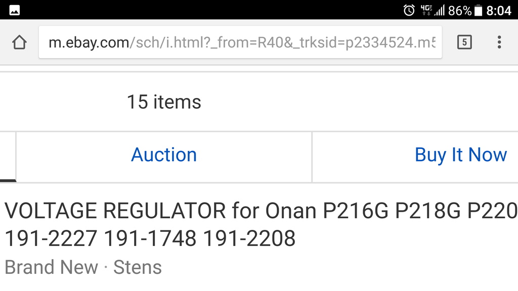

Walhonding520 25 #11 Posted July 12, 2017 Would you have a art number for that eBay regulator Share this post Link to post Share on other sites
gwest_ca-(File Mod) 11,990 #12 Posted July 12, 2017 The charging system on the Onan's is 20 amp so the regulator needs to be rated at 20 amp. http://www.partstree.com/parts/toro/parts/nn10261/ I doubt you need a regulator. The discolored terminal indicates that one was over heated which is caused by a loose or corroded terminal. Clean it up and tighten the terminal slightly so it has a tighter fit on the regulator. The point of resistance could be between the wire and the terminal which would require replacement of the terminal on the wire to correct it. I like to solder the connections after a new terminal for a life-long repair. Keep an eye on it. Garry 1 Share this post Link to post Share on other sites
WVHillbilly520H 10,378 #13 Posted July 12, 2017 9 hours ago, Walhonding520 said: Would you have a art number for that eBay regulator Share this post Link to post Share on other sites
