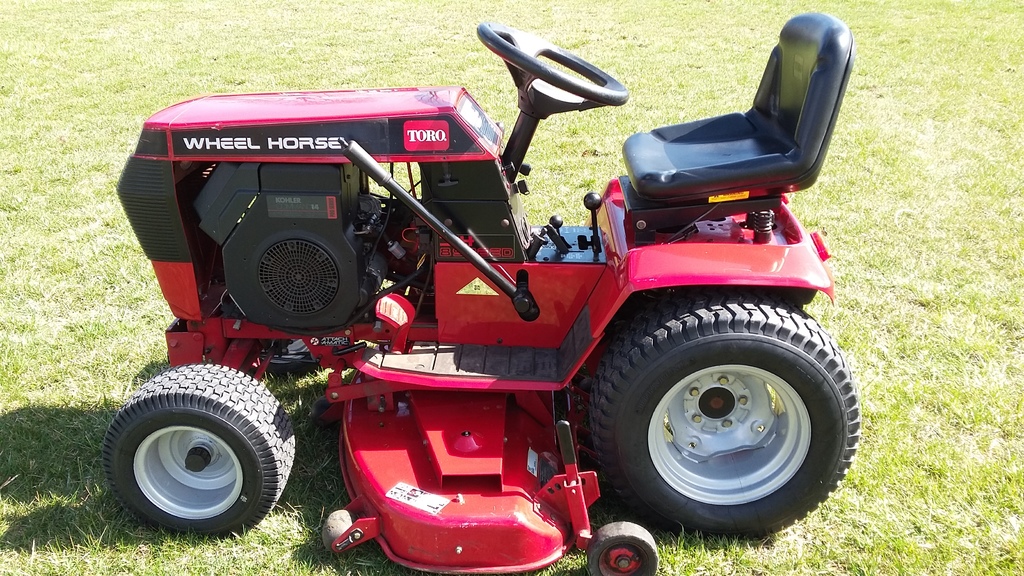

BOB ELLISON 2,981 #1 Posted June 16, 2017 My 314-8 starts and runs great I cut the grass last week and parked it in garage. I went to move it today and it vibrates like it's not balanced even when the deck isnt ingaged. When i cut my grass and I could feel a vibration come and go like a bad out of balance wheel going down the road on a car.i started it today and I could feel in my feet a vibration that tingles after a long time and it's at all speeds. Could it be a crank bearing ? Is the timing fixed on these command engines or can they get out of time? I removed the flywheel and cleaned it good, All the magnets are fine and I pulled off PTO and checked and bearings looks and spins ok. It starts good on the second try. but I did notice that when it starts I hear 2 snaps like the sound of a spark plug makes when it's off the plug and arcs to metal. So my question is what else could make this vibration. Timing, out of balance rod bearing or something else ??? I know it's not the deck, flywheel looks great, I haven't taken the drive belt off yet to see if that is it (Monday for that). Like I said in my other post I don't know a lot about these command engines but I'm a quick learner. Ps I did get my $25.00 wheel weights on 2 Share this post Link to post Share on other sites
