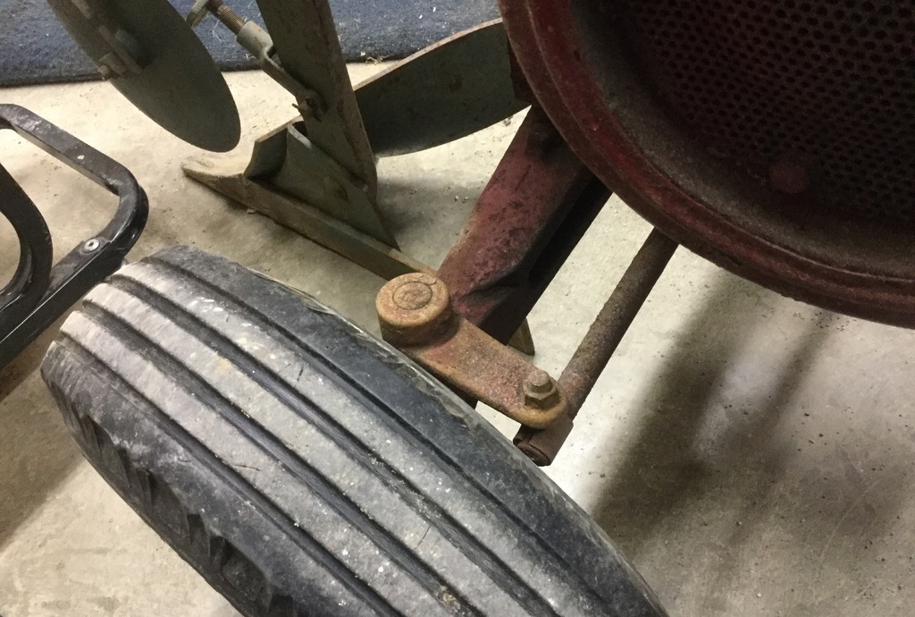

ACman 7,746 #28 Posted June 19, 2017 (edited) Here's a pic of my 753 . Same notch on right side. Edited June 19, 2017 by ACman 1 Share this post Link to post Share on other sites
Racinbob 13,213 #29 Posted June 19, 2017 Oops! I totally forgot about the different spindle design with the arm above the axle. There still might be something to my theory but it just happened later. I'm thinking I'm driving myself nutzo. 1 Share this post Link to post Share on other sites
TDF5G 2,074 #30 Posted June 20, 2017 I read this yesterday at work so when I got home last night, I took a look at one of my tractors, the B-100 and there is the notch. It looks like it could be clearance for the spindle arm when turning hard left as mentioned. I wonder why they only put one on the left. On the right the spindle arm hits the stop when making a full right turn. It appears that you could turn sharper to the left than the right IMO. It's very curious and interesting, ain't it? Share this post Link to post Share on other sites
