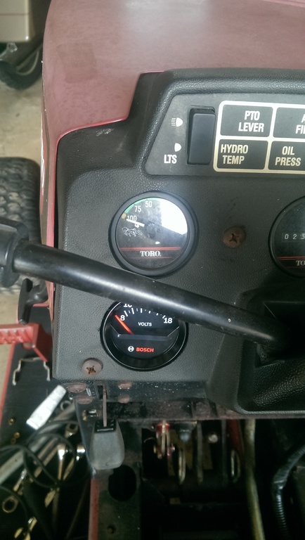

Paul Van Benschoten 18 #1 Posted June 15, 2017 I just brought home a 1995 520H. I think it is in good shape. The wiring looks a little iffy - there are a lot of spliced wires. The main thing I have a question about right now is the throttle lever. When I move it all the way up (higher RPMs) it goes back to the middle. It stays in position in the middle or at the low end. Is there a tension adjustment on the pivot on the lever ? The volt meter always reads zero and the gas gauge always says full even though I know the tank is mostly empty. I can live with those things for a while. thanks PS it is hard to type after spilling a beer on the keyboard. I have to use cut and paste for few letters. 4 Share this post Link to post Share on other sites

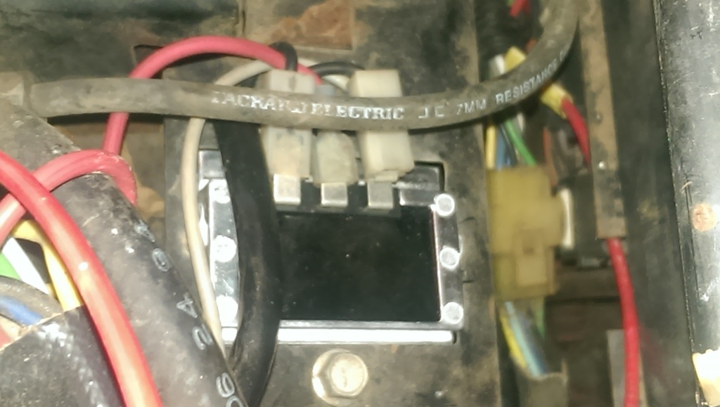

WVHillbilly520H 10,376 #8 Posted June 16, 2017 On your "0" volts showing on the gauge 1 or 2 things the gauge itself is bad and this can be verified by a multi-meter while running to see if it's actually charging and if not #2 the voltage regulator is bad (common problem) and needs to be changed first then if gauge still not registering replace that too, The voltage regulator is $10 eBay/Amazon and the gauge (2 1/16") $20 at an auto parts store, and as for the wiring down load the demystification guide with the wiring diagrams for your year model# 520 if the PO didn't have the owner's/operators manual also down loadable here too, and become a supporter it helps keep the lights on here as well as the ability to upload pictures for us to help you out when needed, Jeff. Share this post Link to post Share on other sites
Paul Van Benschoten 18 #9 Posted June 16, 2017 MalMac: I removed the block and cleaned the dried grease. Now i can pump fres grease in. The zirc connector did not have hex area to get a wrench on so I assume it is not threaded. WVHillbilly520H: thanks for the pointers. I did get those manuals and i have been browsing them. I had found the voltage regulator. I read 14 volts at the battery when the motor is running. I will look at the meter after i check out the wiring. Share this post Link to post Share on other sites
