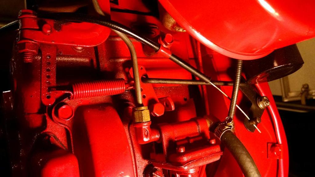

Indiana_Steve 125 #1 Posted June 13, 2017 Finishing up a Raider 10 work horse and for some reason the throttle cable route doesn't look right. I disassemble this last fall and I know I should have taken pics..but I didn't. Anyway cable is original so nothing has changed but it routes right over the exhaust. I have no extra length to re-route elsewhere. Does this look right to you guys? Actually it binds if I try to move it under the exhaust. Share this post Link to post Share on other sites
oldredrider 2,553 #2 Posted June 14, 2017 Looks like your cable/throttle arm pivot is mounted in the wrong hole. Try moving it up to the shiney hole above and to the right (in the first pic). 1 Share this post Link to post Share on other sites

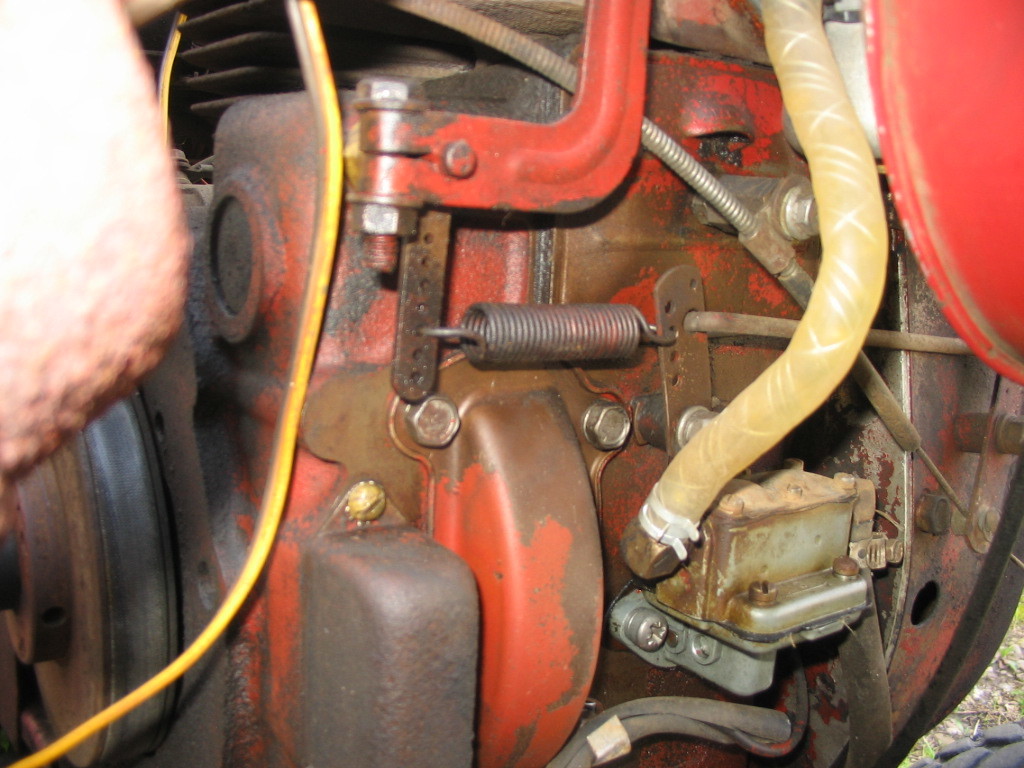

daveoman1966 3,881 #3 Posted June 14, 2017 This is my Kohler 10hp on a B-100..... 1 Share this post Link to post Share on other sites

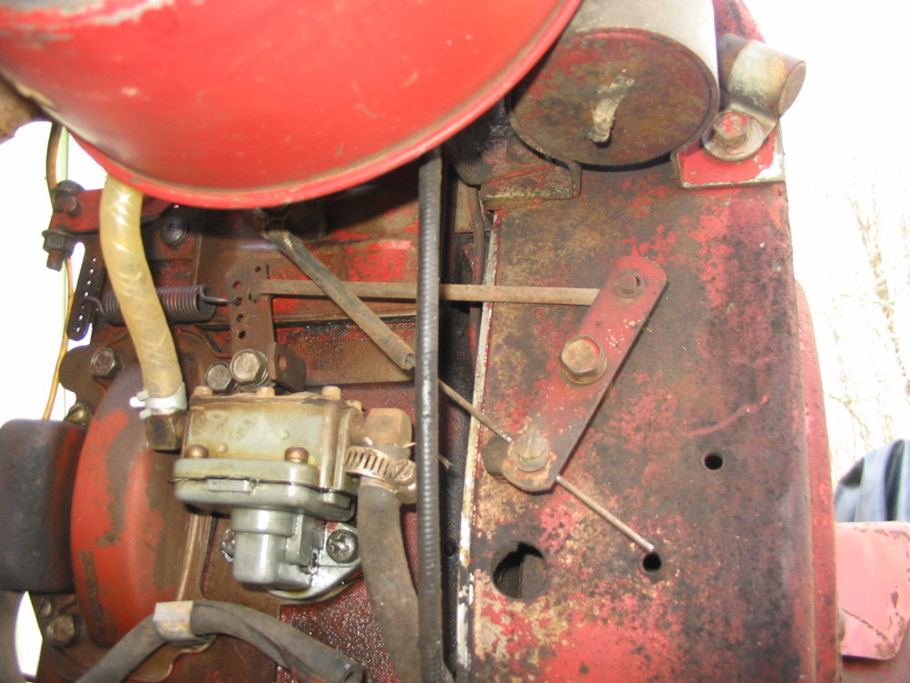

WHX?? 53,372 #4 Posted June 14, 2017 It should go under the exhaust as well but you may have to lose the engine block clamp. I just have the one on the breather and it works well. I just replaced one with one of these and were extra long so had to cut off for that just right fit. http://www.psep.biz/store/toro_mower_cables.htm 1 Share this post Link to post Share on other sites
Indiana_Steve 125 #5 Posted June 14, 2017 Thanks guys for the extra set of eyes. The arm pivot was in the wrong hole. Moved everything around and the cable is off the exhaust and works fine. Started her up after a ring job and she ran fine for the first time in 25 years. 1 Share this post Link to post Share on other sites
