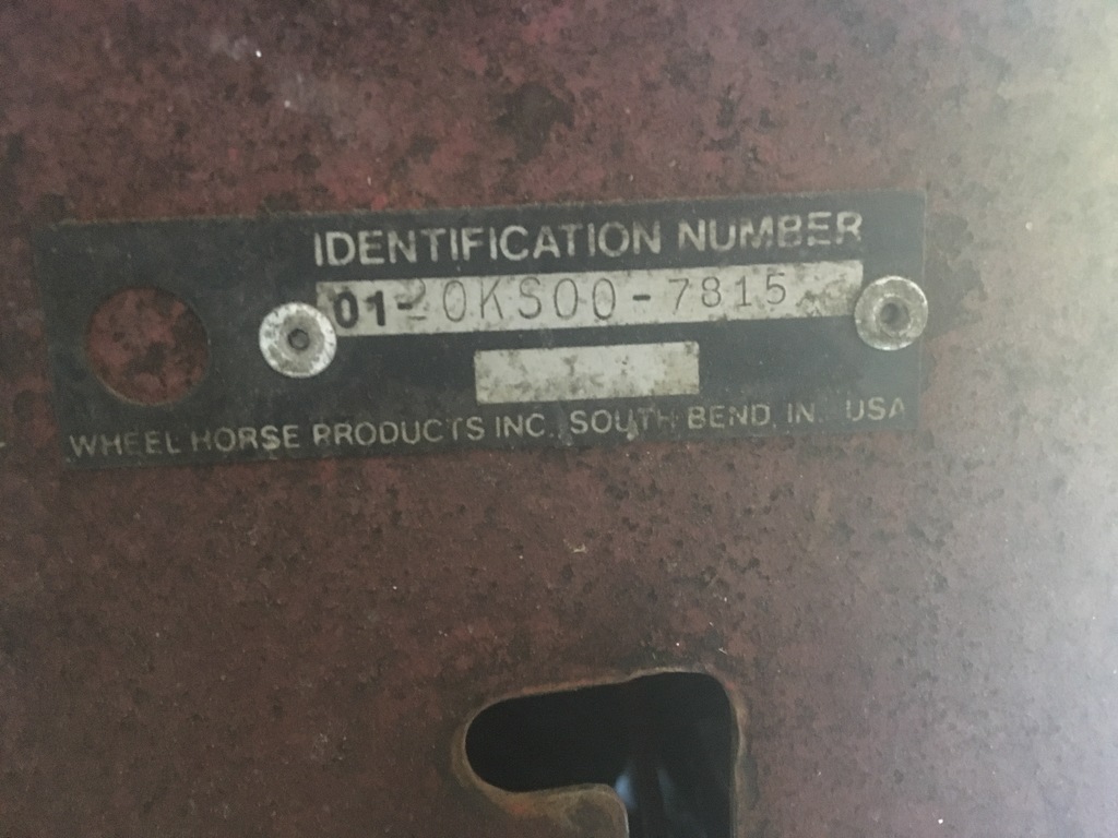

jjs342 1 #1 Posted June 12, 2017 I'm sure it's here somewhere. But I spent two hours alone trying to find it with no answer found. But what oil do I put in the rear of my d200. Year is unknown to be but here's the serial number. Share this post Link to post Share on other sites
Marv 979 #2 Posted June 12, 2017 10w30 or 10w40 engine oil. Marv Share this post Link to post Share on other sites
pfrederi 18,643 #3 Posted June 12, 2017 Most likely 10w-30 or 10w-40 motor oil. Double check wipe the dipstick on a clean paper towel, tan or brownish it is the motor oil. if it is red it is Dexron 3 ATF. Stick with what ever is in there, Share this post Link to post Share on other sites

jjs342 1 #5 Posted June 13, 2017 Thank you all so much. What's in there is black like well worn engine oil. But smells like atf Share this post Link to post Share on other sites
