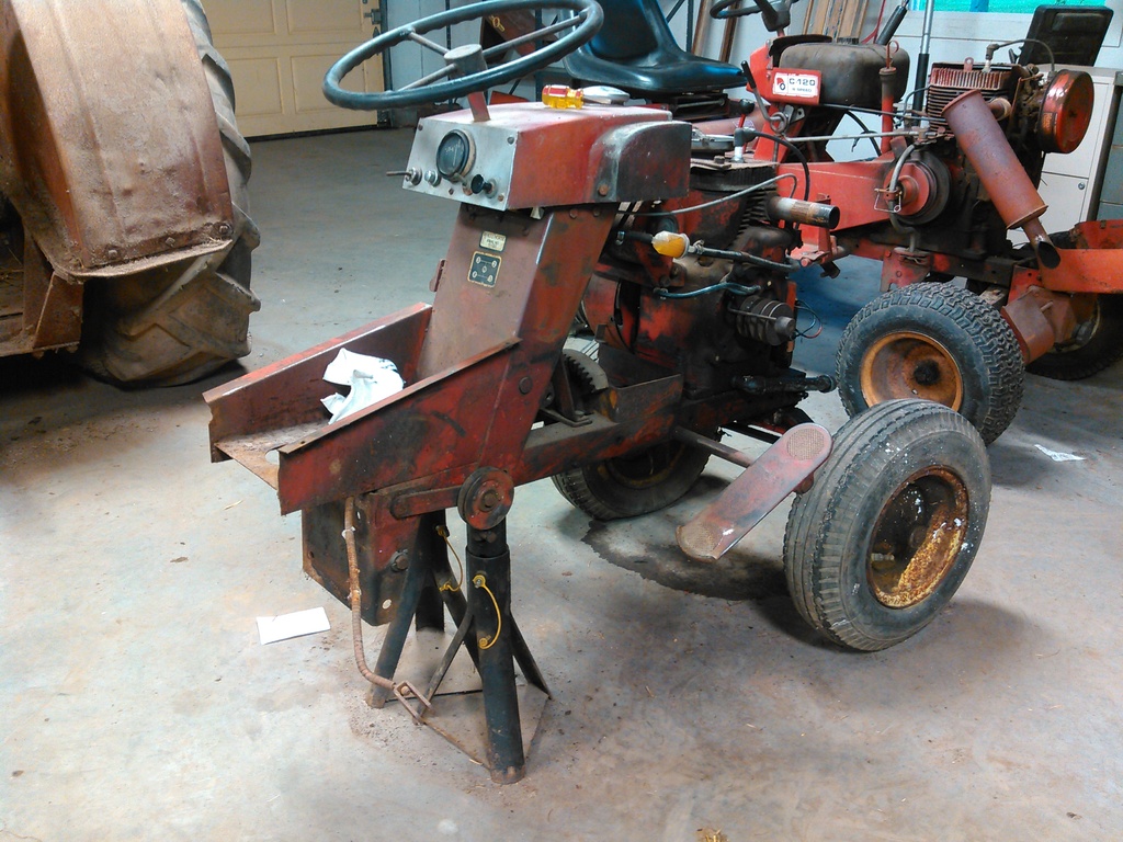

Mikey the Monkey 701 #3 Posted June 4, 2017 Well thank you sir. I just started my first Wheel Horse resto on a 701. Is there supposed to be a spring in there? Did not find one when I took it apart 1 Share this post Link to post Share on other sites
