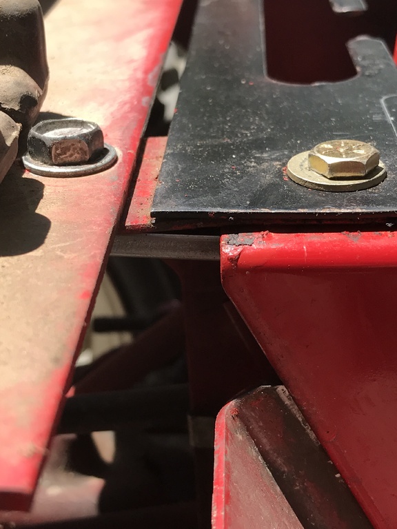

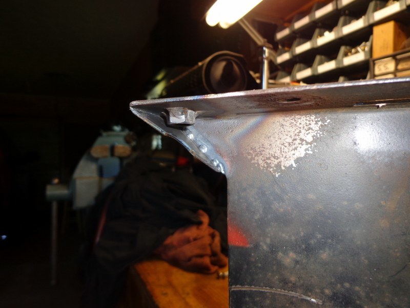

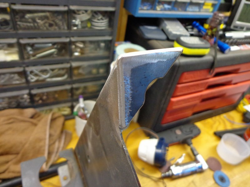

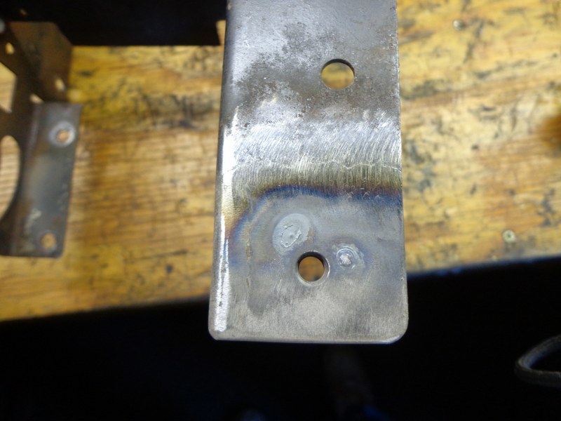

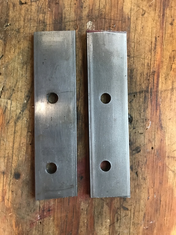

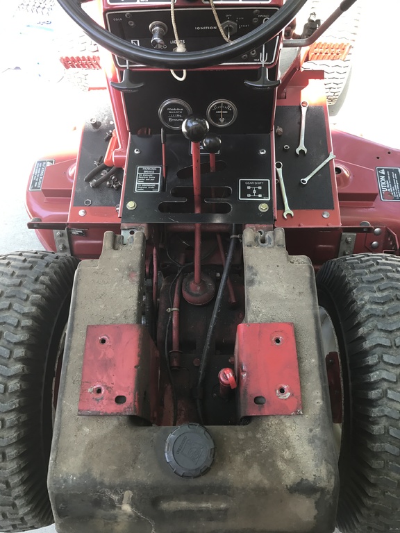

Al C. 1,428 #1 Posted June 3, 2017 Today as I swung myself into the seat getting ready to mow the lawn, I heard a crack. The kind that makes you sick to your stomach. Got off to see what happened and noticed the seat was loose. Well the pictures tell the rest of the story. Fortunately, three hours later, its as strong as ever and ready for another 35 years of seat banging. 13 Share this post Link to post Share on other sites

Pollack Pete 2,273 #6 Posted June 4, 2017 I've repaired many Horses the same way.When I got one of my 312-8's,the seat was bent so far back that I had to remove the uprights between the gas tank and straighted them out.I guess it didn't bother the previous owner sitting on a rocking chair while mowing. Share this post Link to post Share on other sites
CTBT&D 77 #7 Posted June 4, 2017 I also have repaired two of these, cut out the broken area, weld in a new piece with a nut and add a gusset for strength. Craig 4 Share this post Link to post Share on other sites
