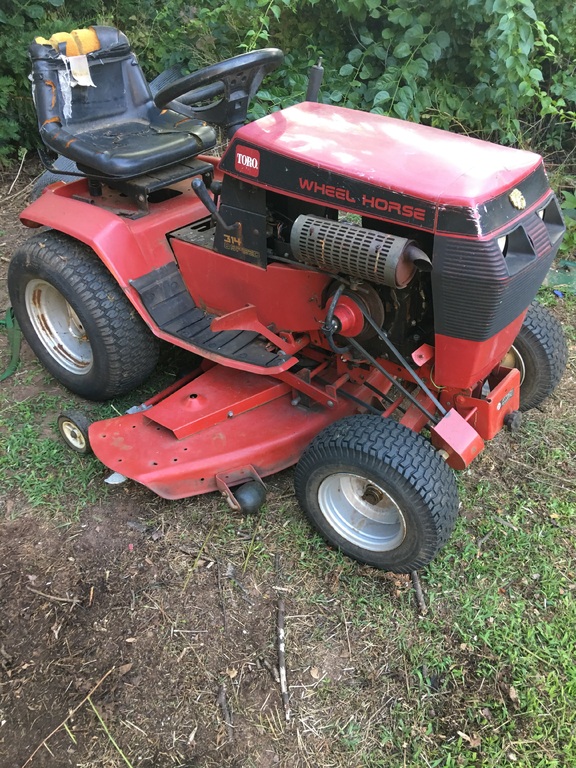

DaleDewitt 0 #1 Posted June 1, 2017 Hello, new here. Need some advice from the pros! putchased a 314-8 with a snowblower but no deck. Found a 37" deck from a 310-8 but from what I've read here so far it seems a 37" deck won't work? Or is it adaptable? Thanks in advance. Share this post Link to post Share on other sites
nylyon-(Admin) 9,035 #2 Posted June 1, 2017 The issue with the 37" deck is the front wheel clearance. The 310's have 6" front wheels where I believe the 314's have 8". To work properly, you could swap out the front wheels and axles from another machine and your 37" deck will work fine. If you're interested in doing this, I have a 312-8 with 6" wheels which I would be willing to swap with you. Share this post Link to post Share on other sites

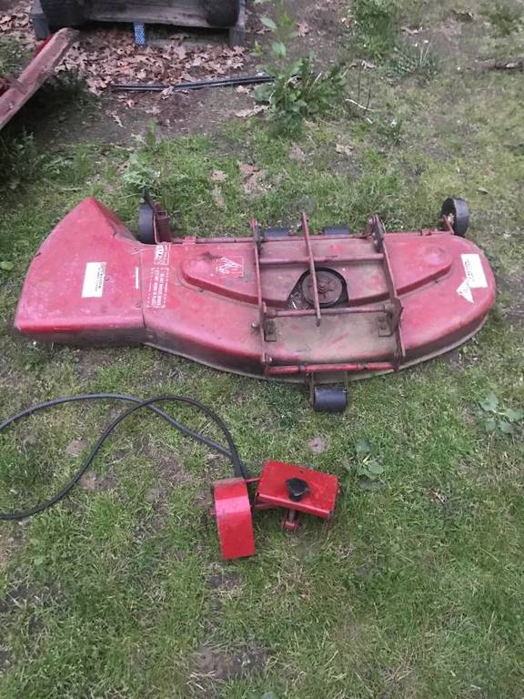

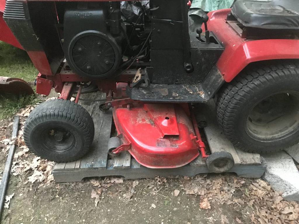

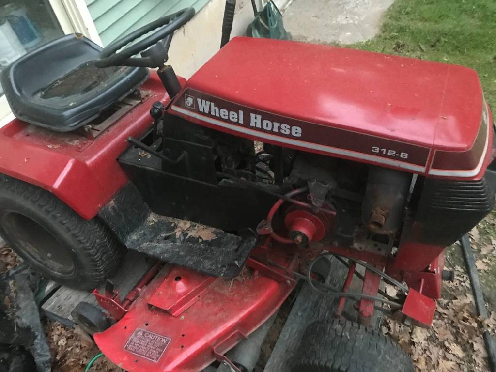

DaleDewitt 0 #16 Posted June 4, 2017 Found these decks today seller doesn't know what they are but is willing to sell me one. Wonder if any of you guys can identify and tell me if either will work on my 314-8. Share this post Link to post Share on other sites
dcrage 636 #17 Posted June 4, 2017 The 2 mounted on the tractors will for sure attach. They are horizontal shaft engines as is your 314. Not sure what the stand alone deck is. Some one else will need to confirm it is suitable for your tractor. Share this post Link to post Share on other sites
nylyon-(Admin) 9,035 #18 Posted June 4, 2017 The one on the tractor looks like a 48", that's a good one. The one off the Tractor doesn't have greasable spindles, and likely has double D blades. Take the one mounted on the tractor! Share this post Link to post Share on other sites
