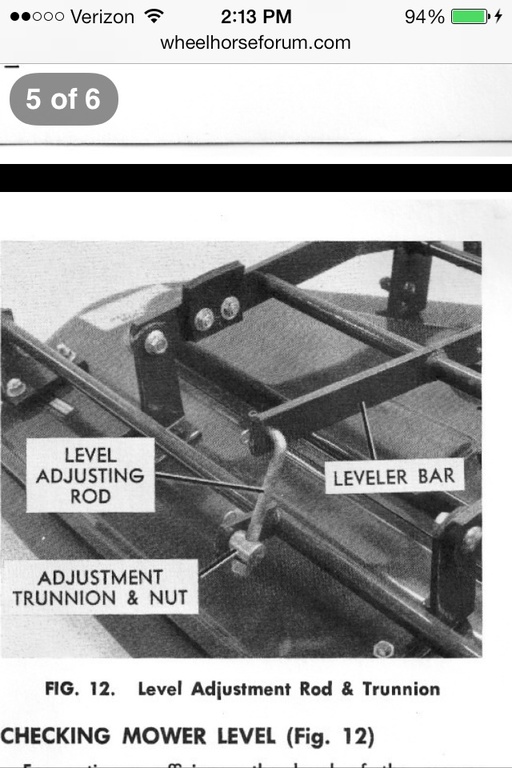

B-100 10 #1 Posted May 31, 2017 I have a 75 (ish?) B-100 with a 36" rear discharge deck. I was mowing today and found that I couldn't raise the deck up and lock it, and found that the level adjusting rod assembly had came off, and after 2 hours of looking, couldn't find it. Does anyone know if this is still available anywhere? I've attached a photo from the manual, I'm missing the rod, trunnion, and nut. Share this post Link to post Share on other sites
daveoman1966 3,882 #2 Posted May 31, 2017 That rod and trunion is about 5 in long...right? If so, I ahve one and can put it in your USA mailbox for. $15.... my email address is: daveoman@windstream.net contact me there for further details. Share this post Link to post Share on other sites
B-100 10 #3 Posted May 31, 2017 I'm not real sure on the length, I only have the picture to go by now. Maybe someone that has one of these decks could verify the length? Share this post Link to post Share on other sites
Tankman 3,528 #4 Posted May 31, 2017 1/2-13 all thread and two trunnions would work if you can't find the rod you need. I have a large BIG horseshoe magnet, on a rope. I sometimes send the grandsons out to collect hardware, nails, bolts, out to collect metal. Share this post Link to post Share on other sites
slammer302 2,157 #5 Posted May 31, 2017 I've made my own with a long bolt and cut off wheel and bending the bolt in a vise Share this post Link to post Share on other sites
