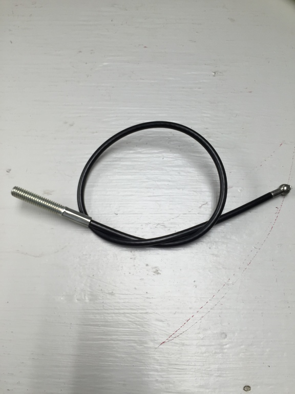

Duramax7man7 506 #1 Posted May 30, 2017 Anyone ever have this happen? I made a rock shaft last night and hooked up a rear plow and made about 8 passes about 20ft long and then headed back to the garage to make a few passes with my tiller and the cable snapped. I blew out the tube before placing the cable but I didn't grease it up. I also had to only use 2 links and a mini clevis hitch from the rock shaft to the clevis lift bracket... That normal? Here's the cable..... It seems that it pulled right out of the threaded end. Maybe a bad cable or was it binding inside the tube? Share this post Link to post Share on other sites

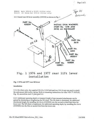

Duramax7man7 506 #3 Posted May 30, 2017 (edited) Going to be making another one but found it odd that it did this. It's literally a brand new cable. What slot is the chain link supposed to be for the rear plow? Edited May 30, 2017 by Mastiffman Share this post Link to post Share on other sites

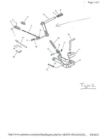

Duramax7man7 506 #5 Posted May 31, 2017 Thanks. Top exploded parts view is mine. For the 300-500 series tractors and others. Not the B-Series. The break was at the rockshaft end with the threads for the trunion. The cable pulled right out of the threaded bolt. I picked up some coated 1/8" steel cable from Menards along with some cable clamps and used a mini clevis hitch given to me. I used the mini clevis on the end for the lift arm and then looped the cable through a slip trunion on the rockshaft side. Problem now is that the belt given to me with the tiller is too short for my 520h... By a good 8"+ Share this post Link to post Share on other sites
wheelhorseman 3,241 #6 Posted June 1, 2017 On 5/30/2017 at 4:39 PM, Mastiffman said: Anyone ever have this happen? I made a rock shaft last night and hooked up a rear plow and made about 8 passes about 20ft long and then headed back to the garage to make a few passes with my tiller and the cable snapped. I blew out the tube before placing the cable but I didn't grease it up. I also had to only use 2 links and a mini clevis hitch from the rock shaft to the clevis lift bracket... That normal? Here's the cable..... It seems that it pulled right out of the threaded end. Maybe a bad cable or was it binding inside the tube? Definitely a bad cable! This is the (new toro replacement) of the #108144 cable - WOW -- they looked cheaply made online and now this confirms it and notice the unprotected ball end - the cable will eventually start to fray/break by the clevis from wear/ vibration - for comparison here is a picture of the one I make (just like wheel horse did)!!!!! 3 Share this post Link to post Share on other sites
Duramax7man7 506 #7 Posted June 1, 2017 Yeah man that's what I thought. Didn't seem right that it just pulled right out of the bolt... Share this post Link to post Share on other sites
Sarge 3,470 #8 Posted June 1, 2017 The roll form die crimp is critical to the strength of those cables , without a properly set up crimper and dies they will fail . If done correctly , the ends should exceed the cable's strength rating . There is a whole new market of wedge type cable ends now available , some of those may work for certain applications requiring a clevis but not sure about the threaded stud type . Lowell's parts will easily meet or exceed the original ratings and his quality is second to none ... China doesn't have a chance against Lowell , we truly appreciate his efforts here and hope he lasts forever.... Sarge 4 Share this post Link to post Share on other sites

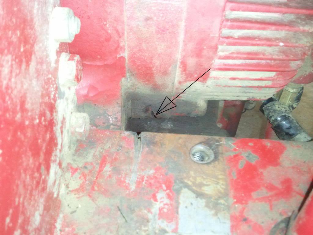

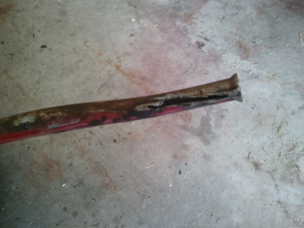

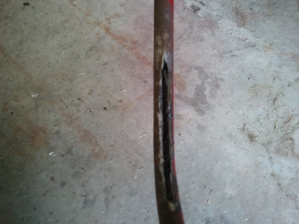

wheelhorseman 3,241 #12 Posted June 3, 2017 Before you install a new lift cable it would be a wise idea to double check your cable tube for wear. Here is a few pictures of what they look like when there wore and where they can damage the transmission. 5 Share this post Link to post Share on other sites
Sarge 3,470 #13 Posted June 4, 2017 That is a very , very good point Lowell - I had almost forgot about that . The old C-160 had worn it's tube badly and I found it by mistake cleaning up some oil underneath while I had it on ramps after changing the hydro oil . That one got replaced with a new tube made from the harder 400 series SS that is used on high pressure gas/fluid systems . The stuff was no fun to flare the end and tore up a Mac flaring tool , but it's done and should last a long time . Very impressed with the quality of your cables , sourcing that spiral conduit isn't easy nor cheap - same with a crimping machine capable of doing those end fittings . Sarge 2 Share this post Link to post Share on other sites
R. L. Addison 299 #14 Posted June 15, 2017 The coating should be stripped off the cable ends before crimping, if not, it is a recipe for disaster! The coating (plastic) is supposed to protect the tube, and it will stretch and shrink therefore releasing the pressure of the crimp and allow it to slip out. 1 Share this post Link to post Share on other sites
Duramax7man7 506 #15 Posted July 21, 2017 On 6/15/2017 at 0:58 AM, R. L. Addison said: The coating should be stripped off the cable ends before crimping, if not, it is a recipe for disaster! The coating (plastic) is supposed to protect the tube, and it will stretch and shrink therefore releasing the pressure of the crimp and allow it to slip out. Thanks Lowell for the pro tip! RL, I did figure this out at one point as it slipped a few times in a row. Pulled it off and reattached and it's been working well! Share this post Link to post Share on other sites
