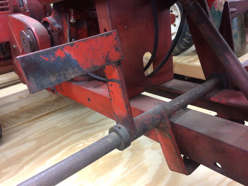

SPINJIM 1,996 #1 Posted May 30, 2017 I'm restoring a Suburban 400, and it has an unusual foot control on the right side. I've never seen this before. I suspect it was to control the angle of a front snow blade, but I'm hoping someone is familiar with it. Jim Share this post Link to post Share on other sites

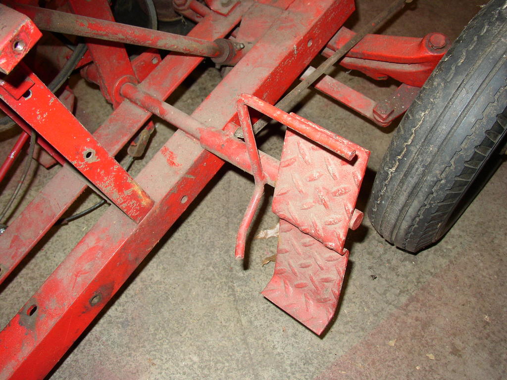

rj35hunter 308 #2 Posted May 30, 2017 That's the engagement pedal for the 1960 only mowing deck This is normally the front snow blade pedal....this is on my 401 5 Share this post Link to post Share on other sites
