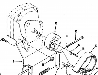

GM_Man 47 #1 Posted May 28, 2017 The other day I noticed a leak coming from my 520-H's brake drum shaft seal. After I started looking into it I noticed that there's an excessive amount of slop in it compared to the one on my C-175. Does anybody know what causes this and how I can go about fixing it? Share this post Link to post Share on other sites
gwest_ca-(File Mod) 11,664 #2 Posted May 29, 2017 Does it look like this? Took them from the 1993 illustrated parts list There may be some movement between the shaft and the drum. If there is at least it is not seized to the shaft. Items 7 and 10 should be the bearing and seal. Garry 1 Share this post Link to post Share on other sites
