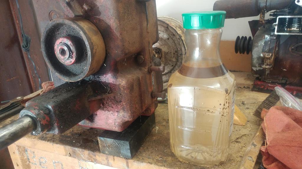

Morecowbell 23 #1 Posted May 27, 2017 So this is what was in my 5025, by some miracle it still seems to be working! So now I'm wondering if I should flush it with something or if I should I just fill it with 90W gear oil and cross my fingers? And any tips on unsticking a stuck drain plug? I drained it from the fill hole, feels like I'm going to strip the allen head socket on the drain plug. 3 Share this post Link to post Share on other sites
Jerry77 1,218 #2 Posted May 27, 2017 i'm just a shade tree mechanic, but I would probably put my brazing tip on my torch and heat it to cherry red to loosen the rust and back it out of there... I imagine you will get a lot of good ideas here... 5 Share this post Link to post Share on other sites
953 nut 63,119 #3 Posted May 27, 2017 Heat is a good rust buster, but working with cast iron I think I would let it cool and apply some PB Blaster or whatever you prefer while it is hot and then after it cools down try removing it. You should put a quart or two of diesel fuel in it and (since you already have it off)use an electric motor or drill to operate it in all gears for several minutes then drain. This will get most of the water out of the bearings. 8 Share this post Link to post Share on other sites

stevasaurus 23,517 #6 Posted May 27, 2017 If you have that trans on the bench like that...why take a chance. Open it up clean it out, check your bearings and replace the seals and gasket. The hard part is already done, and if you are not lucky, you will be right back to where you are. 9 Share this post Link to post Share on other sites

Dakota8338 115 #9 Posted June 2, 2017 I would still fill it with diesel fuel as 953 nut said and let it sit for a week or more, drain and refill with fresh diesel fuel and let sit for a couple more weeks. You will be amazed at what soaking things in diesel fuel will accomplish in a few weeks. 1 Share this post Link to post Share on other sites
