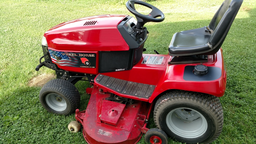

slammer302 2,156 #27 Posted June 18, 2017 1 hour ago, Texas Todd said: Looks nice! I am picking up a 520xi Wednesday myself. May have to upgrade the decals as well! Let us know how you get the old ones off. I believe the decals are on sale. Share this post Link to post Share on other sites

slammer302 2,156 #30 Posted June 18, 2017 Here's a pic of the decals installed looks pretty good for 34$. I used a hair dryer to remove the old decals worked good except for one side the adhesive stayed stuck to the panel. WD-40 worked pretty good at removing it also 90% rubbing alcohol worked also. Tried sum decal adhesive remover but it took the paint off with it. 5 Share this post Link to post Share on other sites

Texas Todd 1,025 #33 Posted June 22, 2017 I picked it up today. Yes, the new decals are a must. Those really do POP compared to the stock ones. I will start a thread, when I get mine going. Looks like the only major snafu is the front bumper trim. I like what you did and just made another bumper. Did you just fab that up? These sure have a different feel from the classics! Share this post Link to post Share on other sites
slammer302 2,156 #34 Posted June 23, 2017 I just used a bumper from a craftsman or a big box store mower and cut the mounting brackets down a little and bent them out a touch and welded it on. Can't wait to see sum pics Share this post Link to post Share on other sites
