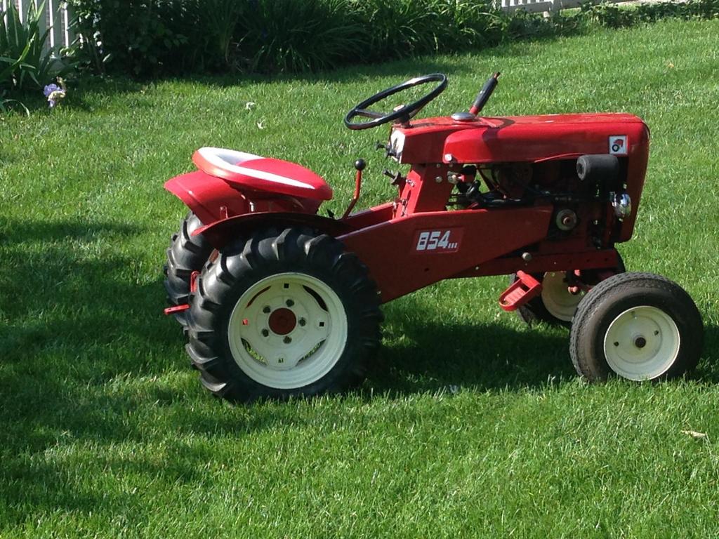

953 nut 64,160 #4 Posted May 26, 2017 854 for sure! You could restore one and keep one in it's work clothes. 4 Share this post Link to post Share on other sites

Racinbob 12,779 #6 Posted May 26, 2017 Aw come on now......are we going to let this 'what model/year is it' get by without other opinions? Ummmmm, yup.....an 854. 2 Share this post Link to post Share on other sites
Chris G 3,369 #7 Posted May 26, 2017 (edited) Nice find. But I got to agree on them being 854's Edited May 26, 2017 by Chris G 1 Share this post Link to post Share on other sites

Uncle Buck 246 #9 Posted May 26, 2017 HEY! Please school me on what screamed 854 about this horse? Was it the steering wheel? Was it perhaps the dash panel? Maybe both? For me it seemed impossible to nail down an exact year, so what gave it away so easily to those of you in the know? More than one model shared that square style seat correct? Looking for my education here fellas! Share this post Link to post Share on other sites
pfrederi 19,930 #10 Posted May 26, 2017 Separate 2 piece gas tank not under the hood. 855 and later had one piece tank under the hood 2 Share this post Link to post Share on other sites
rmaynard 16,875 #11 Posted May 26, 2017 ...and just another little clue, 855's and later (with the exception of Lawn Rangers) were square hoods. And to the best of my knowledge, if those K181 engines there are original to those tractors, there were no 8hp models in 1963 and prior. So that just leaves model year 1964, a hence the 854. Someone correct me if I'm wrong. 2 Share this post Link to post Share on other sites
