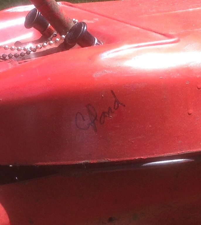

Texas Todd 1,026 #31 Posted June 3, 2017 On 5/24/2017 at 11:03 AM, formariz said: Thanks Ken and everyone for the nice comments. She is sweet and tough. One acre of lawn every three days! Some guy believed in her so much he even signed his name on it. I decided to give your tractor a rest this year since I missed the old girl so much and she was just jealous looking at the stud having all the fun. It's not everyday you see a Cecil Pond autographed edition! 2 Share this post Link to post Share on other sites

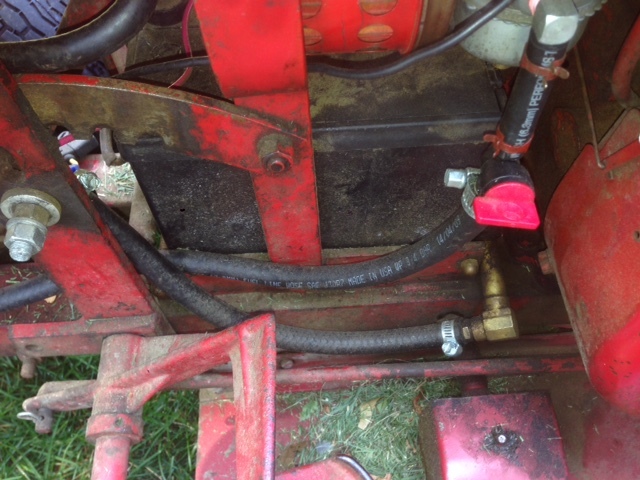

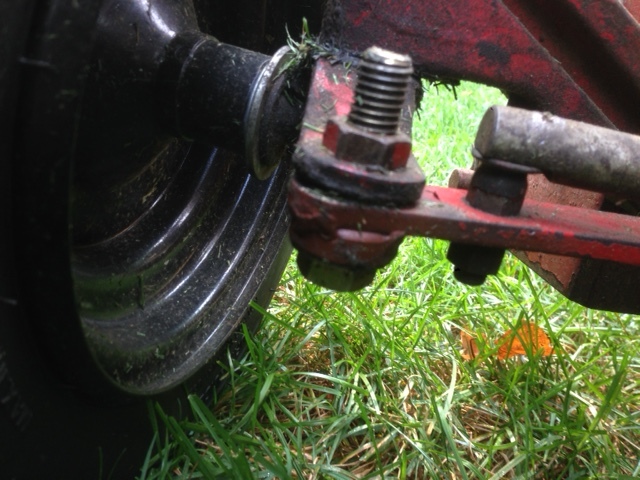

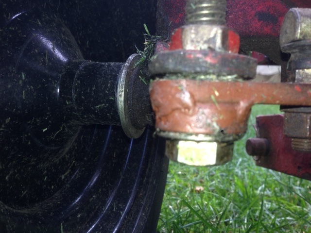

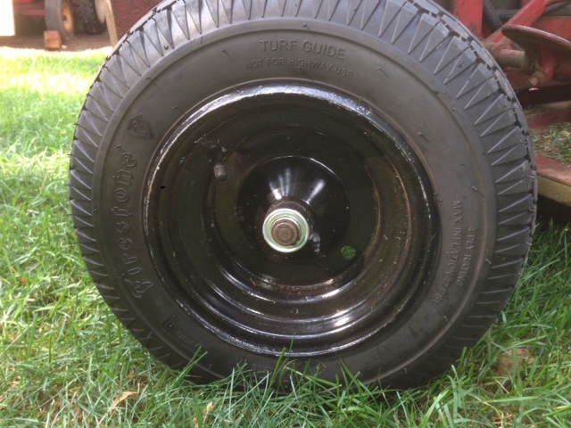

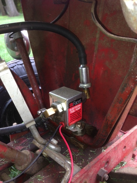

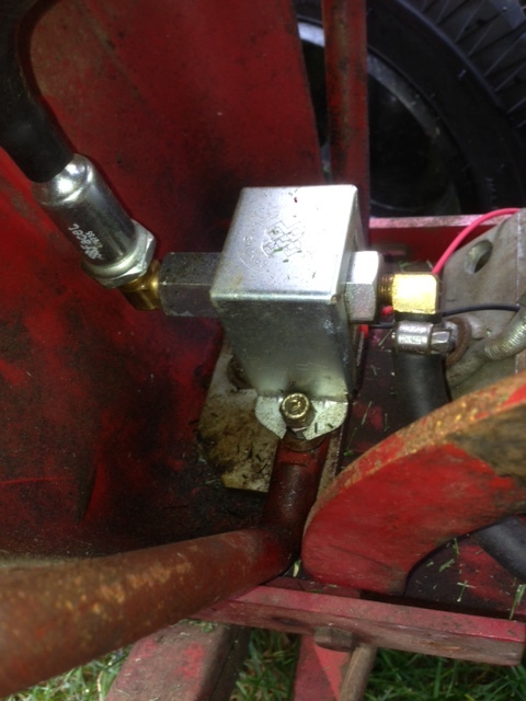

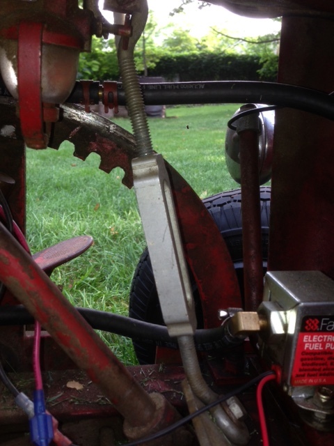

hm12460 53 #32 Posted June 6, 2017 Even the $10,000 and above garden tractor's aren't built to last 50 years. Share this post Link to post Share on other sites
