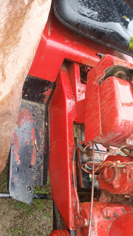

WHX?? 54,976 #6 Posted May 28, 2017 I just bought a parts 1055 that someone down the line put floorboards on so it is possible. Don't appear to be WH boards Share this post Link to post Share on other sites
tallen4392 71 #7 Posted May 28, 2017 Great pic thanks a lot I just use it with the snow blade I have a lot of metal in my legs it is just more comfortable for me not really a huge deal but if they fit off a different machine I would do it thanks Share this post Link to post Share on other sites
