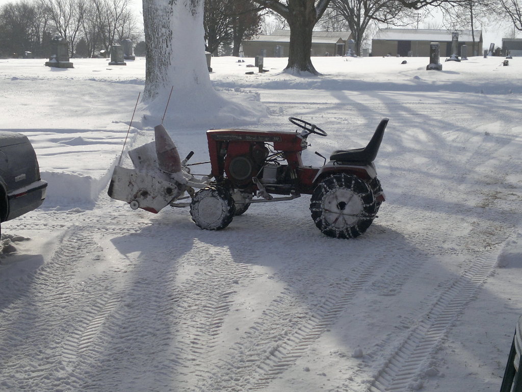

Sarge 3,471 #2 Posted May 23, 2017 You need all the brackets and such for that blower , which the 1077 should be able to handle . There was an obscure upgrade part to bolt on the front of your frame to use the later model front mule drive and your PT-6 clutch setup - it's pretty easy to make one if you are good with steel and some drill bits/grinder . Here is the hitch needed for the front mule drive and other attachments - Hitch_Front_1972_8-5541_1973_8-5551.pdf Here is what it looks like installed - With blower installed - You can also use the later model C series bracket for the front of the frame - it will require a slightly longer front axle pin (3/4" steel) which can be fabricated and it just bolts to the front of the frame , pretty easy mod . Doing that mod allows the use of the newer style decks , blowers and all kinds of other stuff that wasn't available in '67 - but easily obtained today . I wish I could find the file for the upfitter kit , Wheel Horse made kits to adapt newer replacement decks and such to their older tractor models , unlike the other brands of the day . Sarge Sarge Share this post Link to post Share on other sites
