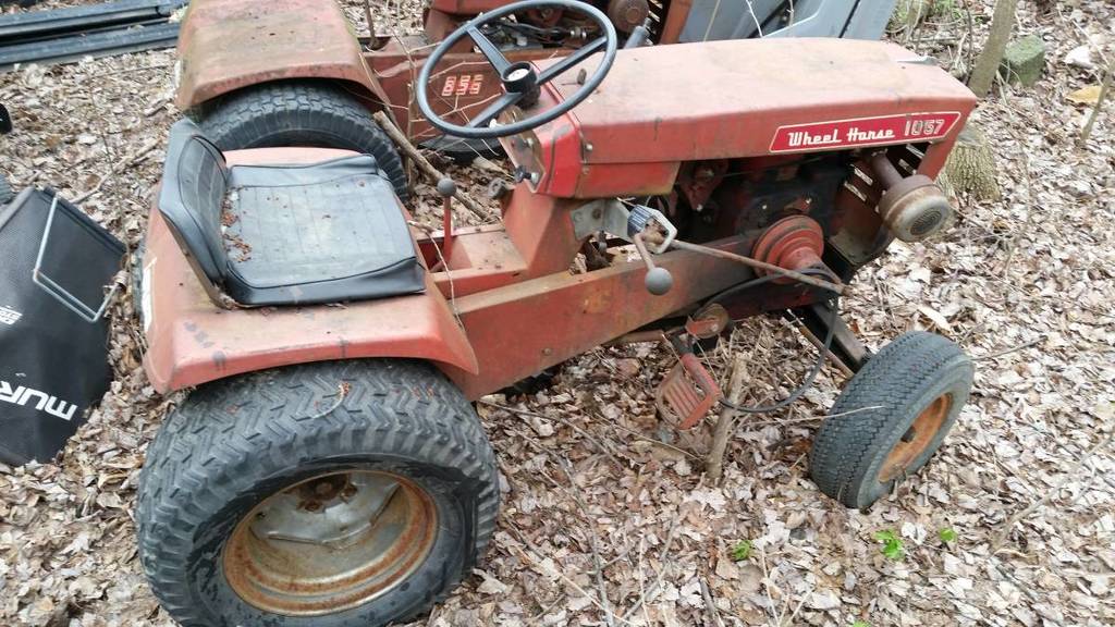

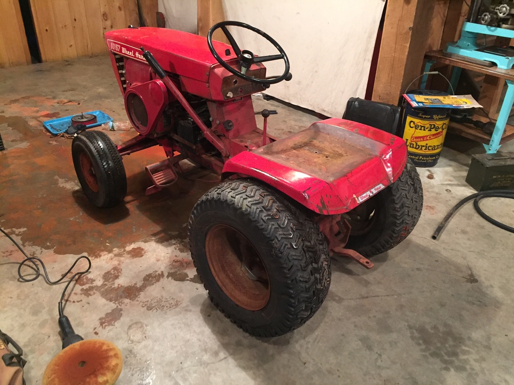

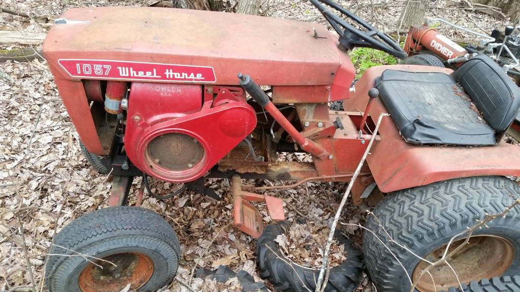

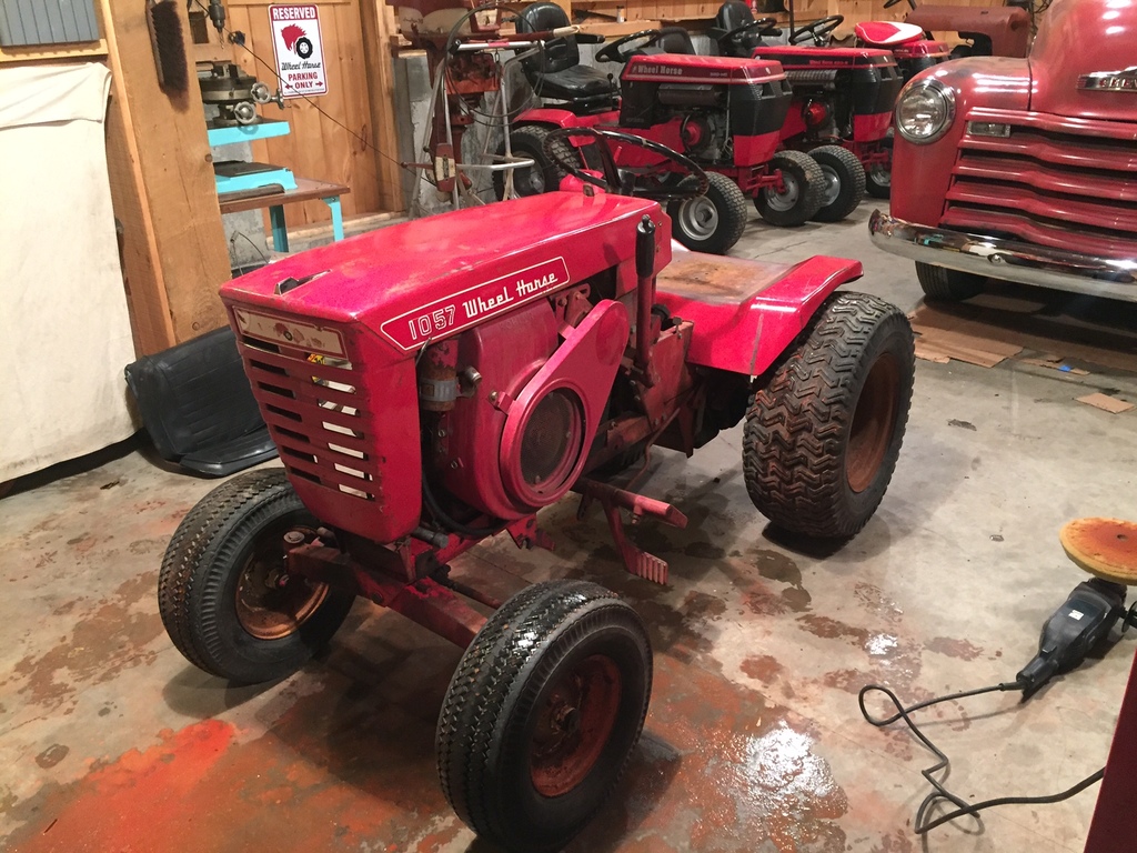

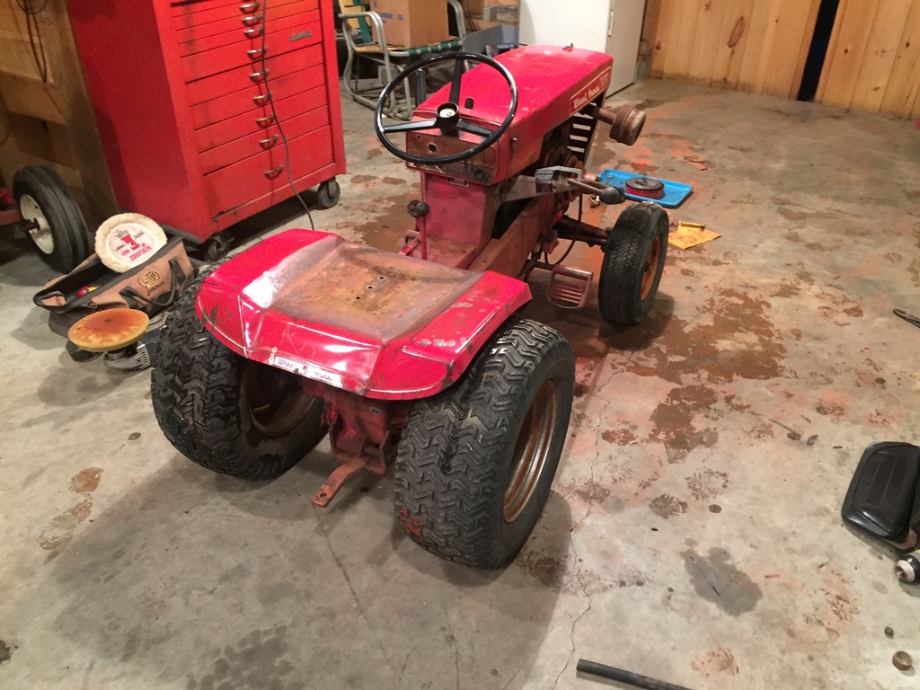

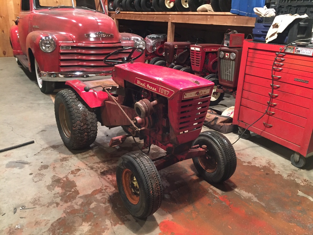

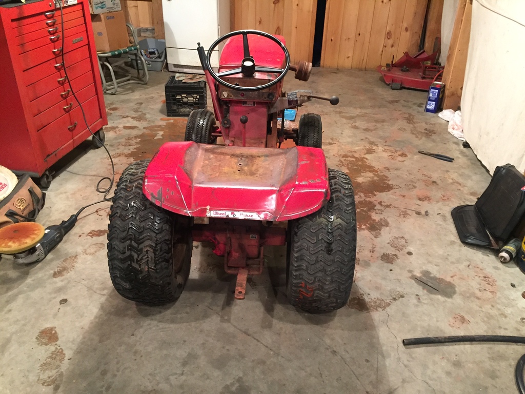

stevebo-(Moderator) 8,541 #1 Posted May 22, 2017 All- I got this one with the assistance of a fellow member here (actually 2) thanks guys! Some pictures of before and after some wet sanding and buffing. Coming along decent however I need to replace the key switch as it works but does not return and that will be an issue in the future I am sure. I tried the search to find a replacement part number for the key switch for a 1057 but could not. It is a 3 poll (battery, ignition and start). Any source or park number would be very helpful. Thanks! 9 Share this post Link to post Share on other sites
gwest_ca-(File Mod) 11,528 #2 Posted May 22, 2017 Garry 4 Share this post Link to post Share on other sites
stratostar250 934 #3 Posted May 22, 2017 I can't believe how much the color came out!! Looks sweet! And I know everyone will argue with me, but I still like those rear tires. 2 Share this post Link to post Share on other sites

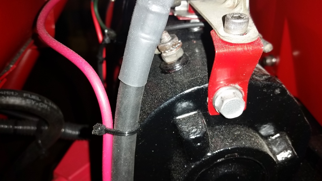

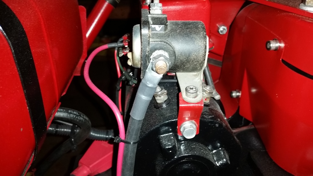

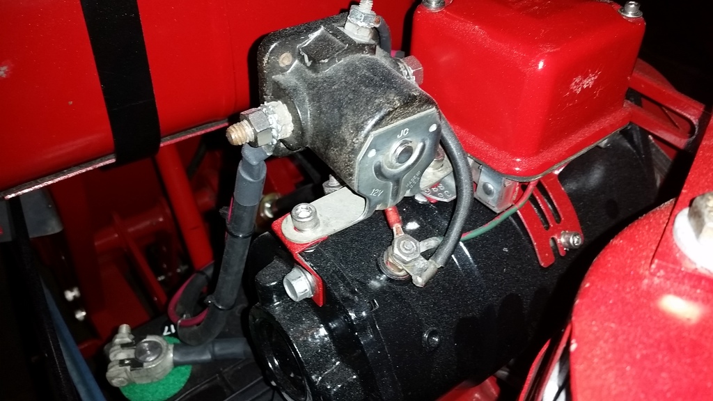

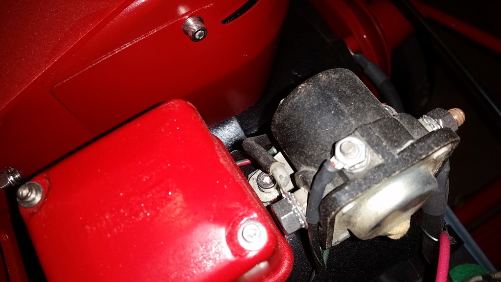

WHX?? 51,916 #7 Posted May 23, 2017 I've got 3 '67s Steve and one has been coverted to solenoid, one has has your sticky return to run issue and one is about there. I have got replacement numbers for these 70 amp switches if you want to stay original but you might not like the price... none less than 70+. I tried all the usual lubricants and finally figured out that return spring in the switch is just 50 year old plain wore out. I fear to think what kind of carnage I might be doing to the S/G or reg. by forgetting to turn the switch to run. If the one on the 1257 gives up I will dissect it to see if it can be saved. Nothing to lose. Anyway maybe some one in the know more than I may disclaim this but my 1067 looks like it was retro fitted by possibly a dealer available kit to change it to solenoid start with the 3 pole switch. It was done in a manner that just doesn't feel PO done if you know what I mean. Factory looking connectors and hardware. I'm sure Garry would have a service bulletin on this tho? Pics on how it was done ...pay no never mind to the hardware and other wiring as this is a custom. Note that the wire going from solenoid to S/G is/might be orginal dealer kit? The bracket from the S/G holding up the solenoid just does not look POish unless the guy was really good but still doesn't fit into the other PO things that were done to this tractor? Mornlikely I am full of cow dung here but something to cud on?? BTW nice '67.. Not sure if the steering wheel is correct but no nevermind ....my favorite year! 3 Share this post Link to post Share on other sites

squonk 43,948 #10 Posted May 23, 2017 Put a solenoid on it and don't look back. You can see mine right where the PTO bracket would be on my 1267. You can use one of the little 3 pole solenoids that most riders use and can be found anywhere. 3 Share this post Link to post Share on other sites
