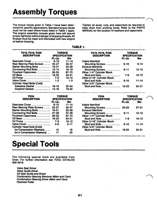

Huntingtown520hc 6 #9 Posted February 24, 2021 Replacing a bad valve gasket on my 520 hc ... does anyone have the torque settings for the intake manifold and the exhaust bolts? Share this post Link to post Share on other sites
lynnmor 8,086 #10 Posted February 24, 2021 1 minute ago, Huntingtown520hc said: Replacing a bad valve gasket on my 520 hc ... does anyone have the torque settings for the intake manifold and the exhaust bolts? Download the Service Manual it will have everything you need. Share this post Link to post Share on other sites
Handy Don 14,658 #11 Posted February 24, 2021 3 minutes ago, Huntingtown520hc said: Replacing a bad valve gasket on my 520 hc ... does anyone have the torque settings for the intake manifold and the exhaust bolts? Share this post Link to post Share on other sites
Huntingtown520hc 6 #12 Posted February 24, 2021 Awesome thanks Share this post Link to post Share on other sites
