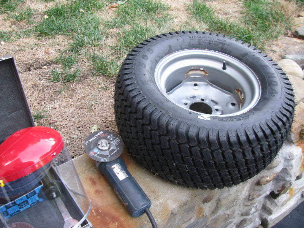

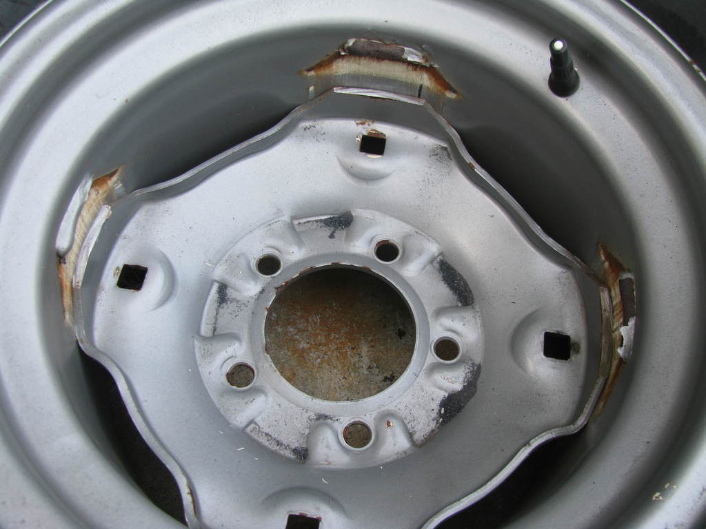

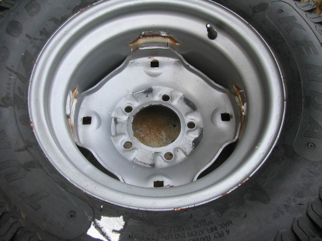

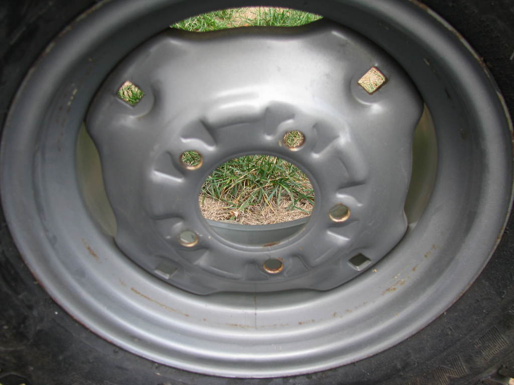

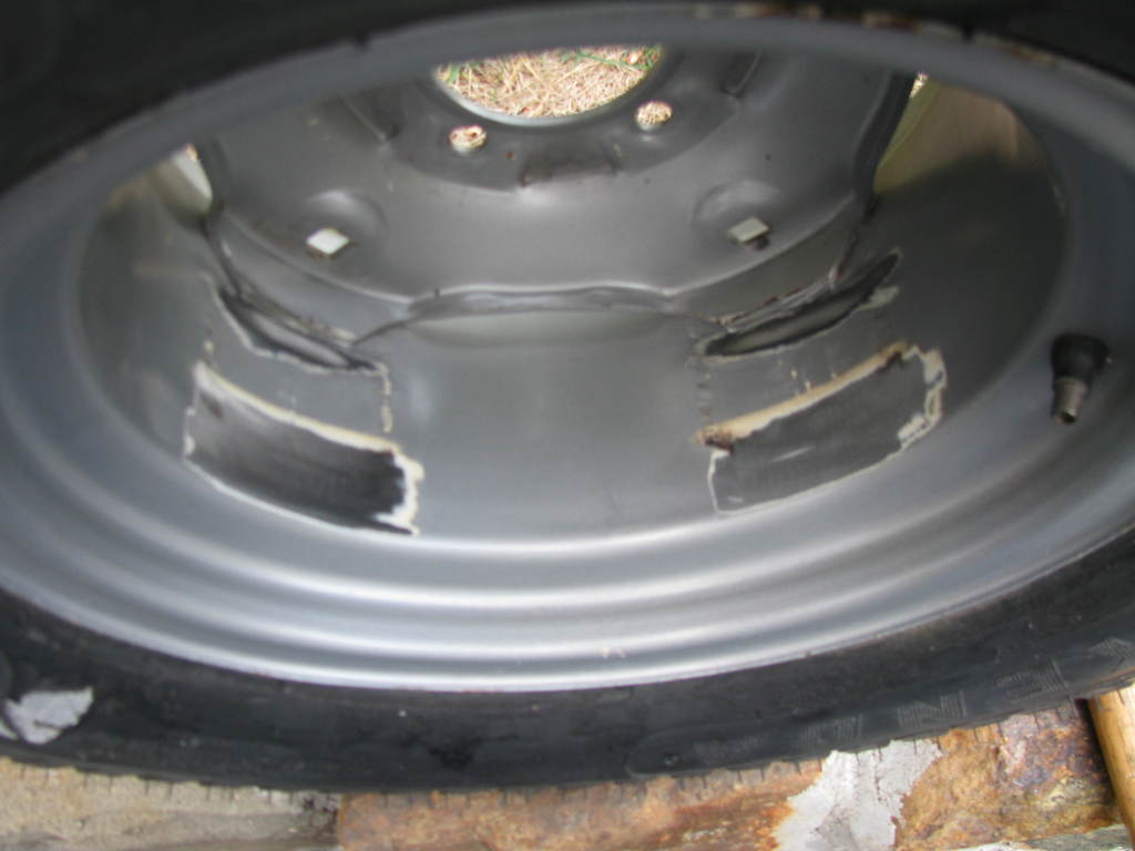

AMC RULES 37,237 #10 Posted June 13, 2017 An angle grinder & cut off wheel is all you need to reset the depth of any rim center. Then simply, weld into place. 2 Share this post Link to post Share on other sites
JAinVA 4,638 #11 Posted June 13, 2017 (edited) I only have a couple WH rims welded with a bead like shown.The angle grinder trick is the deal if your wheels are built that way.Most of my rims are spot welded at the rim/center junction. Miller tire has rim blanks and center sections.You can weld up new wheel sets using what they have. Edited June 13, 2017 by JAinVA Share this post Link to post Share on other sites

ebinmaine 74,851 #13 Posted June 13, 2017 2 hours ago, AMC RULES said: An angle grinder & cut off wheel is all you need to reset the depth of any rim center...... Thanks for putting the face shield in the first photo... good safety reminder. I appreciate the demo photos 'cause I'm thinking of doing the same thing and wondered if its possible. Now I know. I have 2 inch wider-than-stock rear wheels on my B80 and all of the extra 2 is on the Inside and now I can't mount an auxiliary hitch I bought..... Yet. 1 Share this post Link to post Share on other sites
