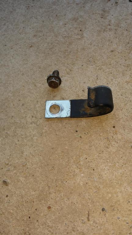

Where does this go?
cafoose

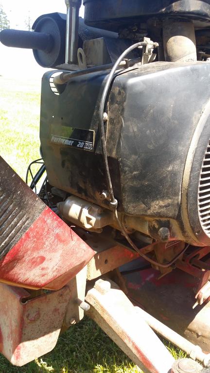

I just finished putting an ignition module in my 520-HC and had this left over. Does anyone know where it goes? :blink: Do I have the throttle cable bracket on correctly? :confusion-shrug:
rmaynard
Without knowing what wiring goes under the cover, my guess is that it helps secure a bundle of wires that included the wire to the ignition module.

cafoose
I kind of thought that I was wondering which bunch of wires exactly where? :confusion-shrug: All the wires seem to be securely fastened. :banana-wrench:
buckrancher
there's one on the upright bracket  next to the coil to hold the wires coming up thru the shroud

cafoose
Maybe someone can post some :text-coolphotos:of the wires around the top and sides of the engine and the throttle cable routing and brackets on the flywheel side? I'm having a :text-blondmoment:as to how they were secured and didn't take enough :text-coolphotos:
Duramax7man7
Under the shroud, there is one that holds the stator wires, ignition module and then another one at the top of the shroud where the stator wires, ignition module and also the oil pressure sensor wires come up out from behind the shroud. So that is two. And then there's another one that is attached right above that one on the air filter box mounting bracket that is closest to the rear cylinder. And then another one on the left (facing the front of the tractor) side of the engine (Looking at the flywheel). There is one down by the oil drain pipe near where the engine mount attaches to the frame and one last one on the front but on the back of the engine near the back side of the starter.
 Those, I believe are the only ones that I've seen. There are usually some zip ties on the harness jacket passing down the oil fill tube down to the starter area.
 Hope this helps.
