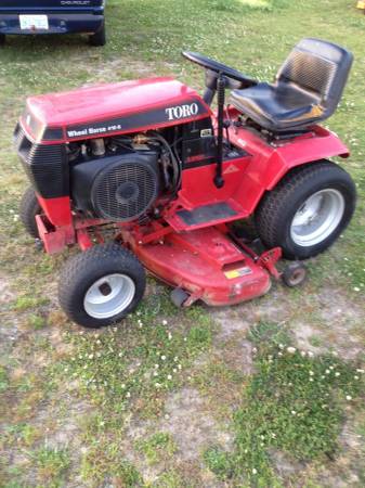

zeke37 24 #1 Posted May 17, 2017 Hey looking at a 416-8 sees to be in pretty good shape. 42" deck, ONAN 16hp that "smokes a little". Says it runs and cuts great. $300. Couple question, is this smoking a sign of a doomed engine? and will this 42" deck be compatible with my current C-160 which has a blown out deck? Here's a picture. 1 Share this post Link to post Share on other sites
daveoman1966 3,882 #2 Posted May 17, 2017 $300 sdoulds like a good price. The 42" deck will make a direct fit to the C-160...nod mods at all. 2 Share this post Link to post Share on other sites
farmer 1,081 #3 Posted May 17, 2017 In my opinion for $300, it would be worth snapping up, if the deck is sound there's your money. The tractor looks ok, might last and you could bang a Kohler on there if the engine fails. Of course it also depends on how far you have to travel to collect? And 3 Share this post Link to post Share on other sites
Racinbob 12,782 #4 Posted May 17, 2017 I would snap that up. To sweeten the deal that's a 48" deck, not a 42". 2 Share this post Link to post Share on other sites
Tankman 3,528 #5 Posted May 17, 2017 (edited) $300! I would go for it, fast. 48" deck to go with the deal too! Edited May 18, 2017 by Tankman 1 Share this post Link to post Share on other sites

Racinbob 12,782 #8 Posted May 17, 2017 From the picture it looks to be in very good shape. Yes, I would go for it and keep my eyes open for a good K, Magnum or Command motor. 1 Share this post Link to post Share on other sites

EricF 589 #10 Posted May 17, 2017 Don't count the engine out completely even if there is some smoke. Clean the breather assembly (steel wool and reed valve) when you get it home. Once it's dirty enough to start pulling oil in and causing blow-by, it will keep doing it -- and keep smoking because of it. If you're very lucky, the fix might be that simple. If not, for $300, it's worth repair or engine replacement! 2 Share this post Link to post Share on other sites
