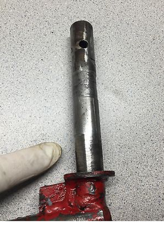

19richie66 17,809 #1 Posted May 16, 2017 Away from my tractor and need to know the front steering spindle shaft size where it goes through the front axle. Is it 3/4" or 1"? Got to order a reamer to install bushings due to wear on the shaft/housing. Do these have bushings in them where they pivot? Not my pic but that is the shaft I need to know. Thanks, Richie Share this post Link to post Share on other sites
Aldon 4,832 #2 Posted May 16, 2017 3/4 non bushed. Thats why I upgraded to 520 axle on my latest GT22-8 To get more beefy spindle. 2 Share this post Link to post Share on other sites
19richie66 17,809 #3 Posted May 16, 2017 Thanks. I guess I should have just called you 2 Share this post Link to post Share on other sites
swisstrac 49 #4 Posted May 17, 2017 re size of spindle is 7/8 i had mine out to do bushing and measured it xxtimes to be sure/ however since this an 69 and old perhaps the previous owne rmay have switched spibndles ?? Share this post Link to post Share on other sites
