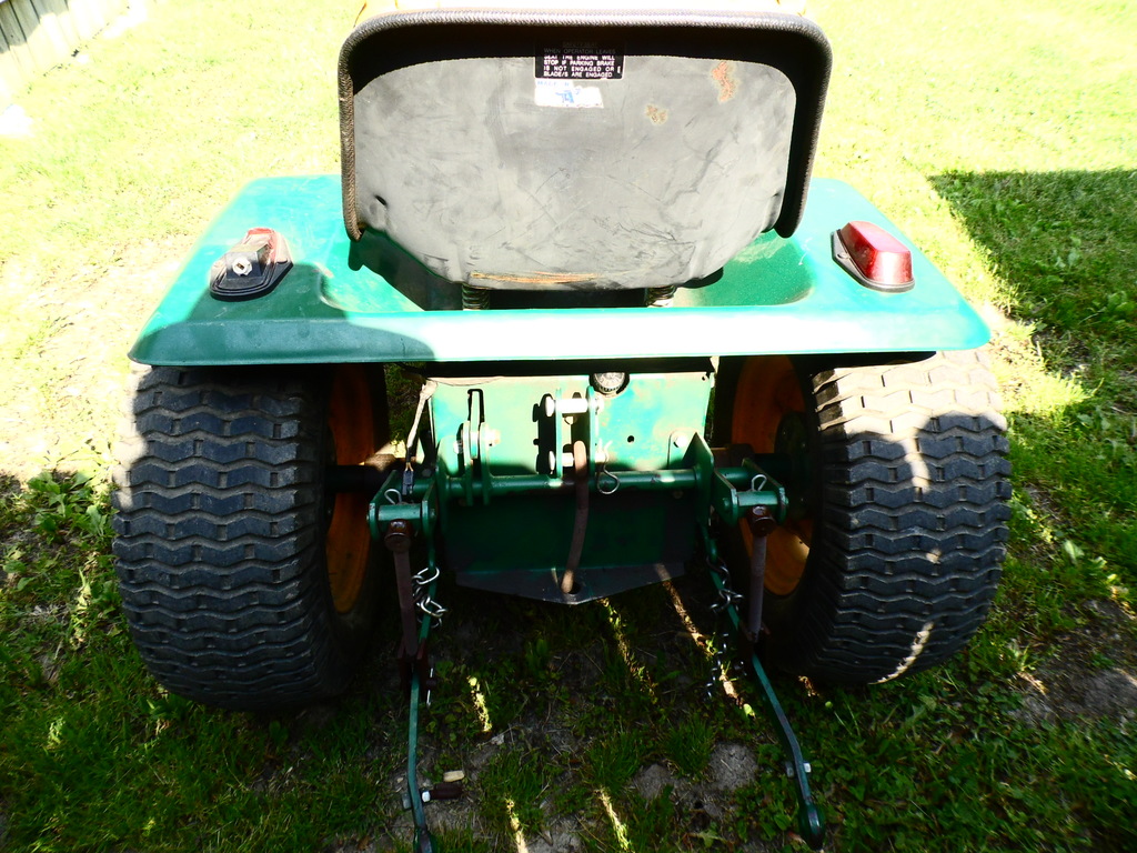

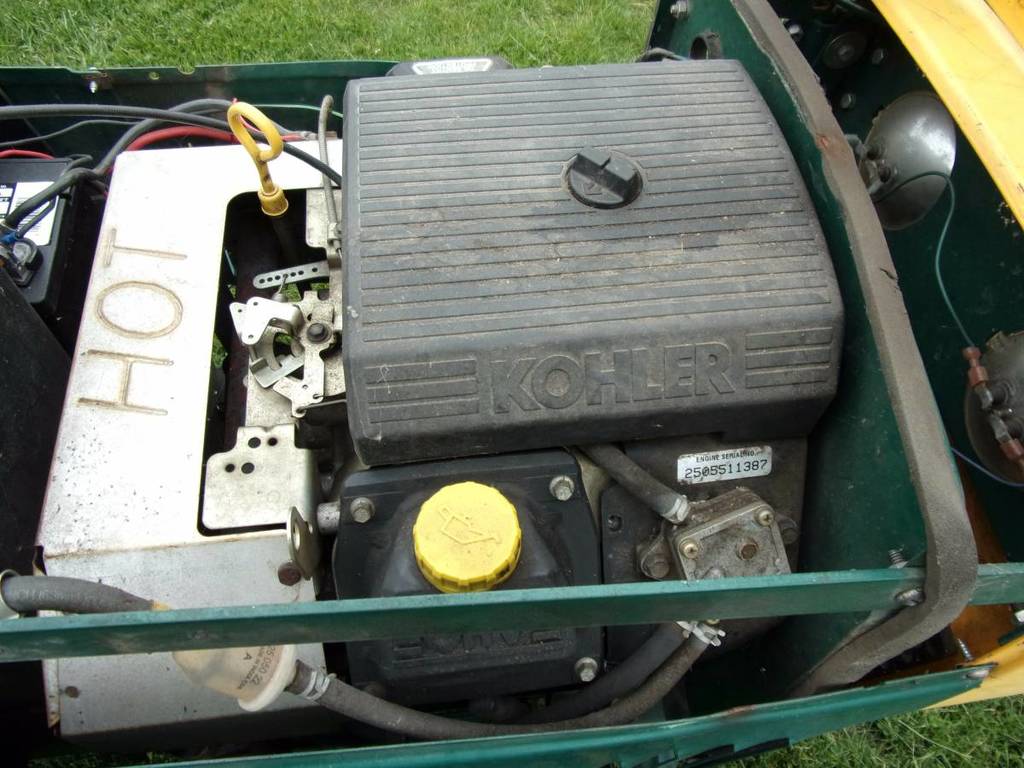

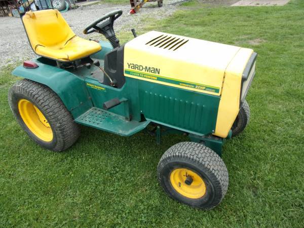

Molon_Labe 731 #1 Posted May 16, 2017 Okay, sorry if I got you J-D fans stirred up for nothing. Ran across my latest project on CL today after ignoring it for quite some time, just because of the name and the colors I failed to open the link. Well, I clicked on the link today and was shocked by what I saw. A 22hp Kohler horizontal shaft V-twin driving an Eaton 11 hydro via drive shaft to a 2 speed Peerless differential. All of this combined with a 3 point cat 0 hitch, front and mid pto's, 27X9.50-15 rear tires and 1" front spindles! What is it? An MTD!!! The CL ad read "Yard Man tractor for sale" and indeed that is what it was but unlike any I had ever seen or was expecting. Just hauled it home this afternoon and after fluid changes and a tune up I'll get started on the cosmetics including a new low-back seat (black) and some olive paint to cover up the yellow, the decals are going away. All of the sheet metal is straight and the dash is in good condition which is a huge plus. It ain't gonna' be pretty but should be quite a worker. 11 Share this post Link to post Share on other sites

DennisThornton 4,773 #6 Posted May 16, 2017 Mercy! MTD make that? 1 Share this post Link to post Share on other sites

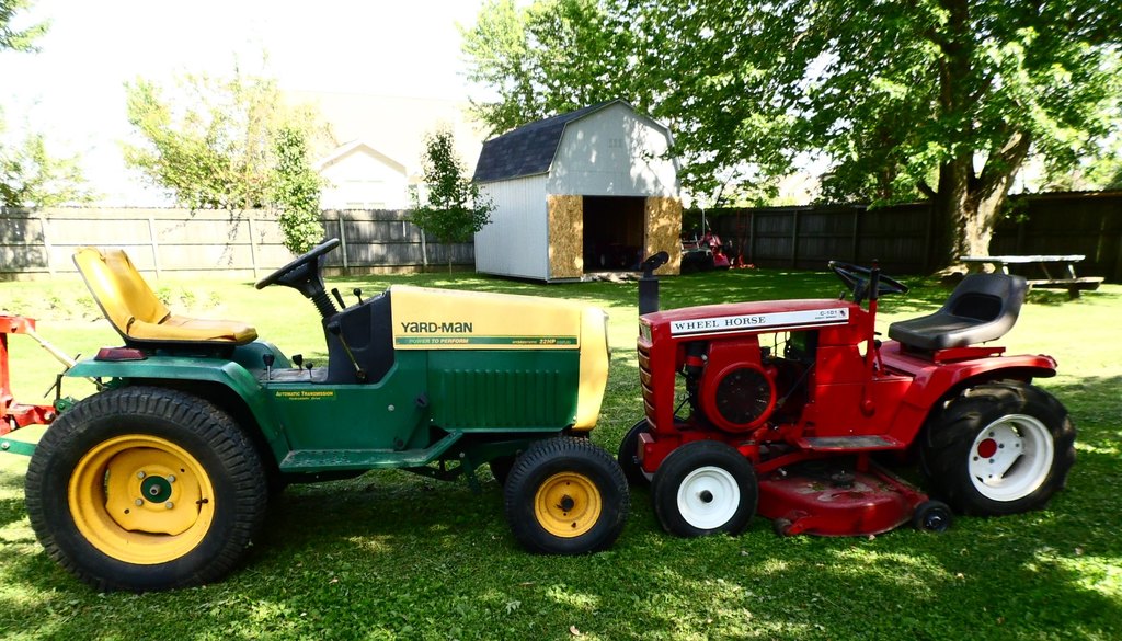

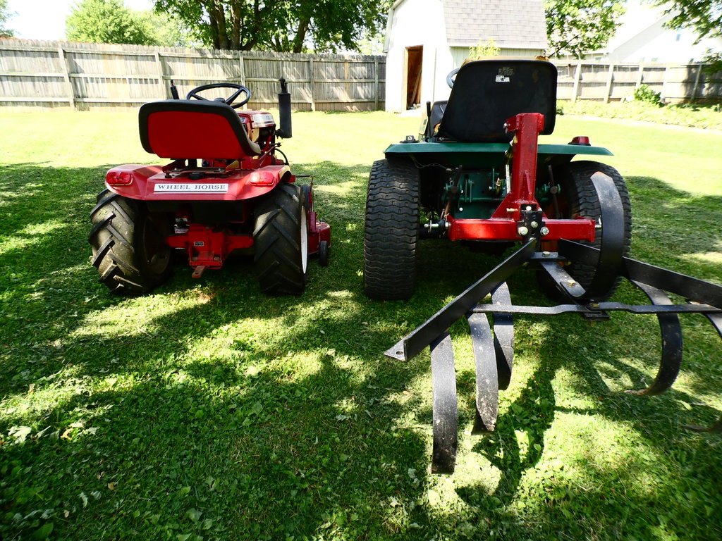

Molon_Labe 731 #16 Posted May 24, 2017 Many of the old Simplicity, Bolens, Allis Chalmers, etc. used Briggs engines and a good number of them are still running. Those were the ones with cast iron blocks with ball bearing cranks. They are still great engines but parts availability is getting more difficult by the year. Just for grins I took a couple of pics for a visual size comparison between the Yard Man and my C-101 9 Share this post Link to post Share on other sites

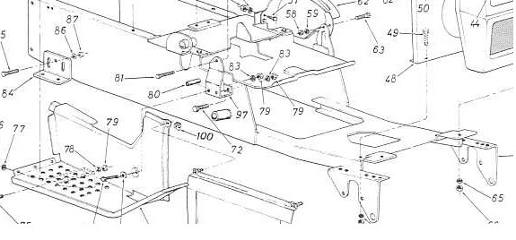

EricF 589 #17 Posted May 25, 2017 Interesting beast! I like the comparison shot -- it looks like it's edging into almost SCUT-size territory. Just curious, how thick is the gauge of the steel that makes up the Yard-Man's frame? As time wore on into the 90s, that was where things started changing and we started losing the really good heavy GT frame deigns. 1 Share this post Link to post Share on other sites
Molon_Labe 731 #18 Posted May 25, 2017 3 hours ago, EricF said: Interesting beast! I like the comparison shot -- it looks like it's edging into almost SCUT-size territory. Just curious, how thick is the gauge of the steel that makes up the Yard-Man's frame? As time wore on into the 90s, that was where things started changing and we started losing the really good heavy GT frame deigns. The frame is 3/16" stepped, automotive style "C" channel with a bolt on 1/4" rear tow plate that the 3 point rock shaft mounts to. These were made until 1999 and are identical to the White GT-2055 with the exception of the 20HP Vanguard vs the Kohler 22HP used in the Yard Man. I had been looking for a White for a long time when this one found me. Share this post Link to post Share on other sites

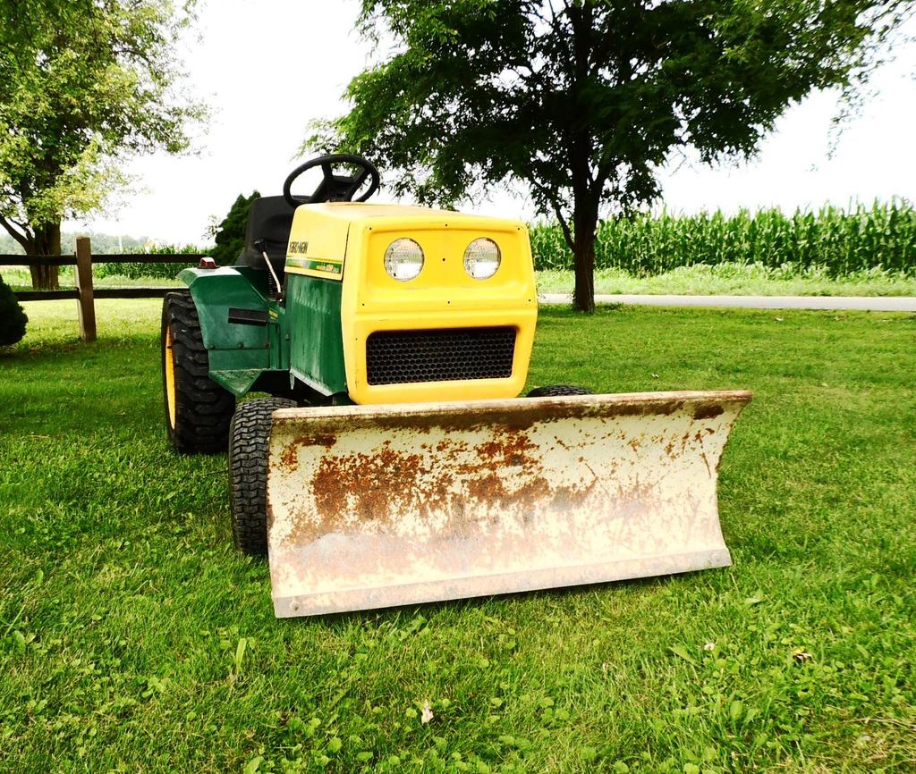

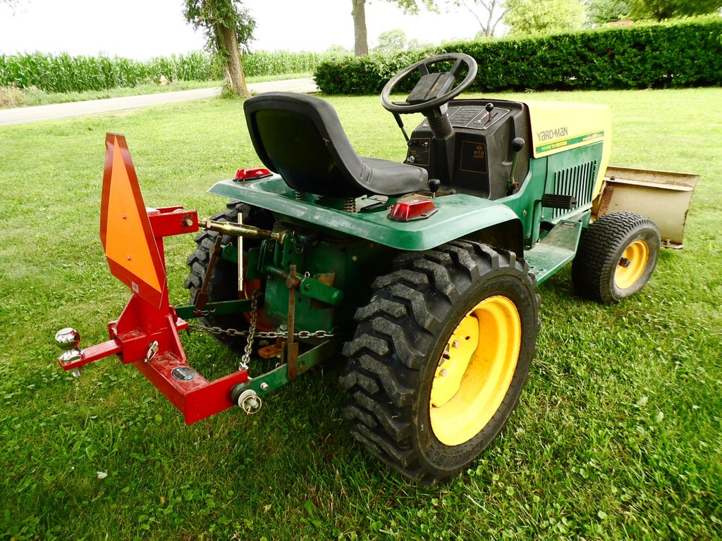

Molon_Labe 731 #19 Posted July 9, 2017 Cleaned 'er up a bit, new seat and R4's for the rear, blade fabbed up and mounted. This one will be the prime snow mover. 4 Share this post Link to post Share on other sites

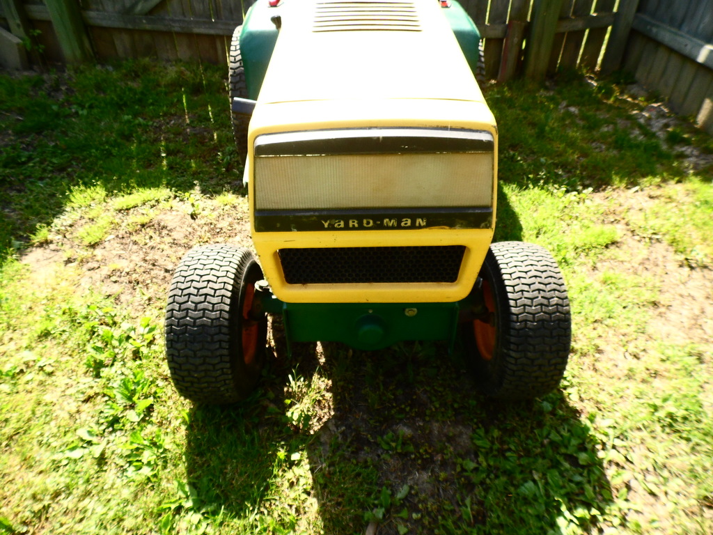

elcamino/wheelhorse 9,363 #20 Posted July 9, 2017 The grill makes it look like it is ready to eat something . Interesting tractor. 2 Share this post Link to post Share on other sites

Amcwheel85 2,060 #23 Posted July 16, 2017 (edited) That is 1 awesome yard man.. kinda like the normal weak small yard man on steroids!! I would love to have one like it.. nice score!! BTW the front looks like a funny EMOJI lol. Wife seen it... laughed and said she wants one! Lol Edited July 16, 2017 by Amcwheel85 1 Share this post Link to post Share on other sites
