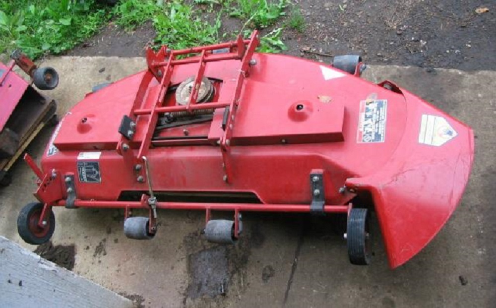

paps03 2 #1 Posted May 15, 2017 I have a 416 with a 48in deck. Could someone send me a pic of how the lift rod on the rear of the deck should be installed? Mine broke and I replaced it with a new one but my deck won't lift properly. The site won't allow me to upload of a pic the way I have it now. Share this post Link to post Share on other sites
daveoman1966 3,880 #2 Posted May 15, 2017 like this... Share this post Link to post Share on other sites

pfrederi 19,020 #4 Posted May 15, 2017 Make sure the trunnion is in the hole closest to the gauge wheel axle. Share this post Link to post Share on other sites
