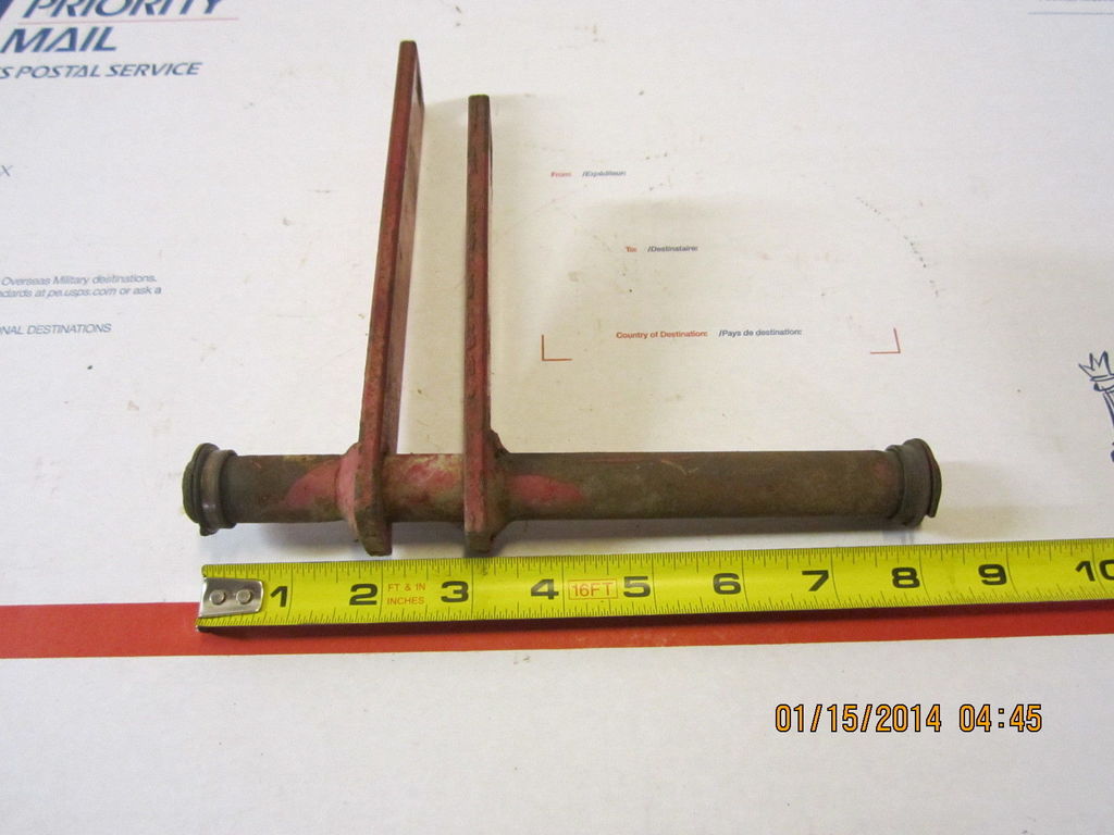

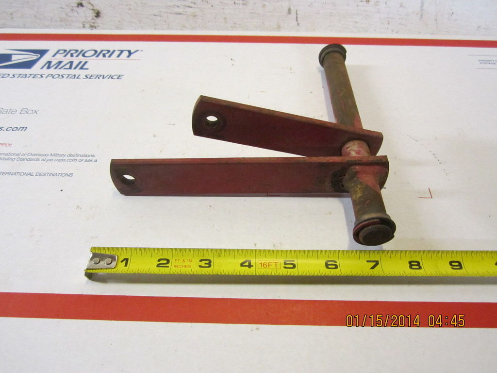

daveoman1966 3,883 #2 Posted May 10, 2017 This is the rock shaft you need for the C-160. I ahve one and it is on Ebay. It is fopr the 1976 and 77 C-160 and C-120 tractors.... Moderators frown on selling in this o0pen forum, but can locate it on Ebay with keywords WHEELHORSE C-160 PIC HERE: PART # 105539 2 Share this post Link to post Share on other sites
6wheeler 676 #3 Posted May 10, 2017 Problem solved. Thanks Daveoman1966. The C-160 will live...... 2 Share this post Link to post Share on other sites
