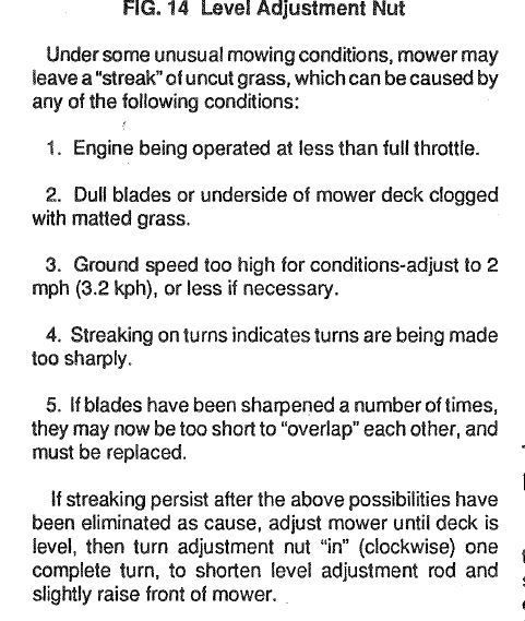

nylyon-(Admin) 8,638 #7 Posted May 8, 2017 Follow this guide: I had an issue with my 42" RD deck this year where it wasn't even close to doing a good job. Using the above guide, I measured the level of the blades and the front blade was severely tilted. I needed to "bend" the housing to get it back to being proper. From there, I made the adjustments, and it is now cutting properly. Be sure that you measure everything indicated, don't assume that because you have had the deck that it's fine (I bought mine brand new and it bent through the years). 1 Share this post Link to post Share on other sites
daveoman1966 3,881 #8 Posted May 8, 2017 could be a combination of two things..or more. 1) mower blade speed is too slow. (2) tractor ground speed is too fast (3) MAYBE... are the 'baffles' in tact on the bottom side of the deck, or have they rotted / rusted away? (4) If these are all but gone, you lose the 'wind tunnel' effect that straightens up the grass for even cut effect. (5) the 'wind tunnel ' aka... vacuum will be less effective if blades rpm is too low. Just some thoughts.... Share this post Link to post Share on other sites

doc724 925 #12 Posted May 8, 2017 A key peice of diagnostic info that would help is "where is the area that is not cut". For example, sitting on the tractor and looking down, if the left blade is number 1 and the right blade is number 3; is the streaking between 1 and two or two and three or both? Root cause can be dependent on the answer you give and also which way you make turns when the streaking occurs. Share this post Link to post Share on other sites
