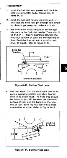

pfrederi 19,783 #2 Posted May 7, 2017 (edited) Check your float. Make sure there is no gas in it. also check the level and drop. Level is 11/64th drop is 1-1/32 Edited May 7, 2017 by pfrederi 2 Share this post Link to post Share on other sites
bizzo15 52 #3 Posted May 7, 2017 2 hours ago, pfrederi said: Check your float. Make sure there is no gas in it. also check the level and drop. Level is 11/64th drop is 1-1/32 Pfrederi thanks for the quick reply. After I posted my question I went into the garage and started removing the carb off the engine. I took it apart and cleaned it with carb cleaner and then I got back on req square and I was going to search for a manual on adjusting the carb when I saw I had a reply to my post. Sure enough it looks like the previous owner installed a rebuild kit including a new float and never adjusted the tab as it was perfectly straight. I adjusted it as close as I could to 11/64th's using my digital caliber and put it all back together. Fired the tractor up and rode it around the yard for a couple minutes and it didn't spit or sputter once. I would've ran it longer but my yard is really wet from all the rain. Anyways I think that's all that was wrong with it so thanks for posting that! 2 Share this post Link to post Share on other sites
