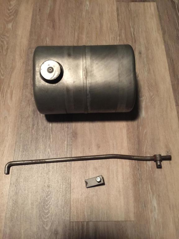

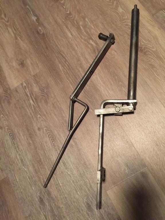

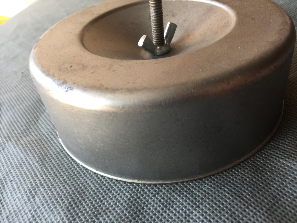

JPWH 6,541 #2 Posted May 6, 2017 I blast everything on mine. Depends on the system you are using I guess. I have heard you can warp the tins. I have.a siphon gun and only run 90 psi. It's a little slow but it works for me. I'm sure some.of the experts will be more helpful. 1 Share this post Link to post Share on other sites
