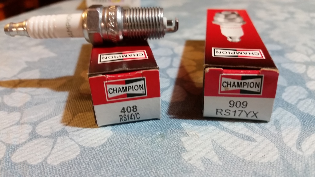

nylyon-(Admin) 8,835 #12 Posted May 3, 2017 Those are the plugs which didn't work well in my Onan 16. From the factory it came with RS17YX and runs better with those, not sure if the same is true for the 20 or not? Share this post Link to post Share on other sites
WHX?? 55,091 #13 Posted May 4, 2017 If I am not mistaken they should be the same as the sweet 16. I also run the the 17's Karl which I was told was a suitable substitute for the 14's. There is a difference in the size of the center electrode tho. The 17 is thinner. I'm certain my 20 hp came with the 14's and runs fine with either. Also certain the books calls out a 14 for any of the Onans. I don't have a pic of the 17 as they're in the 520 now. Got me curious as to what's in the 416 now will have to check. OEM P/N is 167-0272 Also noteworthy as some manuals call out a RS14YC while some call out an RH14YC...typo?? Lots of posts on the correct plug so will have to do some research. My bad on the previous post should be a RS14 not an RC...thats what I get for relying on memory. Two things tho fellas...please don't ask me why I have an empty spark plug box on the shelf and please don't tell my wife I am taking pics of plugs on her kitchen table! 3 Share this post Link to post Share on other sites
